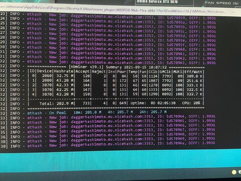

#65537792
GeForce RTX 3070DaggerHashimoto: 33.18 MH/sStatusMiningTemp.40ºCVRAM T.38ºCLoad100%MemCtrl Load65%Fan30%Power95WEfficiency0.35 MH/J HIGH GeForce RTX 3070DaggerHashimoto: 33.18 MH/sStatusMiningTemp.56ºCVRAM T.54ºCLoad100%MemCtrl Load65%Fan55%Power88WEfficiency0.38 MH/J HIGH GeForce RTX 3070DaggerHashimoto: 33.18 MH/sStatusMiningTemp.56ºCVRAM T.53ºCLoad100%MemCtrl Load65%Fan51%Power93WEfficiency0.36 MH/J HIGH GeForce RTX 2080DaggerHashimoto: 43.18 MH/sStatusMiningTemp.54ºCVRAM T.68ºCLoad99%MemCtrl Load88%Fan46%Power103WEfficiency0.42 MH/J HIGH GeForce RTX 2060DaggerHashimoto: 32.37 MH/sStatusMiningTemp.53ºCHotspot T.68ºCLoad99%MemCtrl Load90%Fan36%Power84WEfficiency0.39 MH/J HIGH
A 3070ek LHR.
