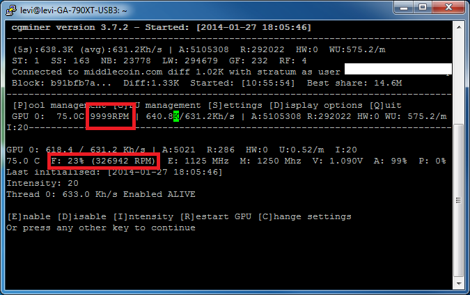

Szia, nekem egy Gigabyte 7950 ezekkel a beállításokkal megy ~630-at, 72 fokon 50%-os ventivel:
"intensity" : "20",
"vectors" : "1",
"worksize" : "256",
"kernel" : "scrypt",
"lookup-gap" : "2",
"thread-concurrency" : "24000",
"shaders" : "0",
"gpu-engine" : "1125",
"gpu-fan" : "0-85",
"gpu-memclock" : "1250",
"gpu-memdiff" : "0",
"gpu-powertune" : "0",
"gpu-vddc" : "0.000",
"temp-cutoff" : "95",
"temp-overheat" : "85",
"temp-target" : "75",
"api-mcast-port" : "4028",
"api-port" : "4028",
"auto-fan" : true,
"expiry" : "2",
"gpu-dyninterval" : "7",
"gpu-platform" : "0",
"gpu-threads" : "1",
"hotplug" : "5",
"log" : "5",
"no-pool-disable" : true,
"queue" : "0",
"scan-time" : "2",
"scrypt" : true,
"temp-hysteresis" : "3",
"shares" : "0" -
