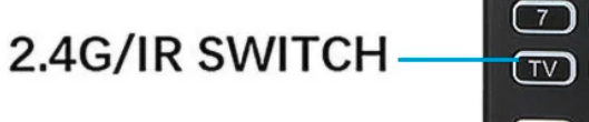

Ja ez az egyik igen köszi.
A gaming modhoz kell pc vagy konzol. De leírás szerint az alsó szines gombok taníthatóak.
IR learning operation as the following steps
1. Pointing IR emitters of the TV remote and the air mouse to each other ,
2. Press and hold the TV key on the remote 4-5s until the LED flash slowly,
3. When you see the LED flashing slowly ,press the key on your TV remote to learn,
4. When the remote receiver the IR signal,the LED will be solid.
5. The 5 keys could learn following the step 1-4,
6. Press the TV button to finish the learning process. -
