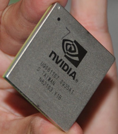

Oliverda
einstein #222 üzenetére
"The first one is from the always great PC Watch, specifically here, but we cropped it a bit for size. Some things to note on it. First is that the second set of digits on the first line says 0935A1. A1 is for first silicon, something that, when coupled with a direct quote from Jen-Hsun of, "You are currently looking at a few day old silicon" (from here select the video "See video of Jen-Hsun Huang announcing Fermi") kind of blows the whole 'silicon in Santa Clara last spring' story out of the water. I wonder if anyone will retract that, or just change the article retroactively?
To make matters worse, the other digits are a date code, 0935 means 2009, work week 35. If Nvidia starts its work week on the first full week of the year like everyone else, that would put WW35 at August 28 to September 5, 2009. Where have I heard that date before? Oh yeah, here.
Last but not least, you have the funniest part, the number seven hand written on the GPU. While this isn't proof of anything, normally when you have small lots of samples, you write numbers on them to identify which one is which as an aid to debugging. Where did we hear that number seven again? Oh yeah, here again." -
einstein
Különben, ha az egész kártya kamu, akkor ez is kamu?

Rive
Huh. Úgy néz ki, hogy az NV PR-osztálya kicsit falnak ment a cikkben is látható képpel
Ui.: az, hogy egy ilyen kiállitásos-mutogatós kártya demo, nem ügy. De az, hogy a PR-osztály mást állit - na, az fejjel a falnak
