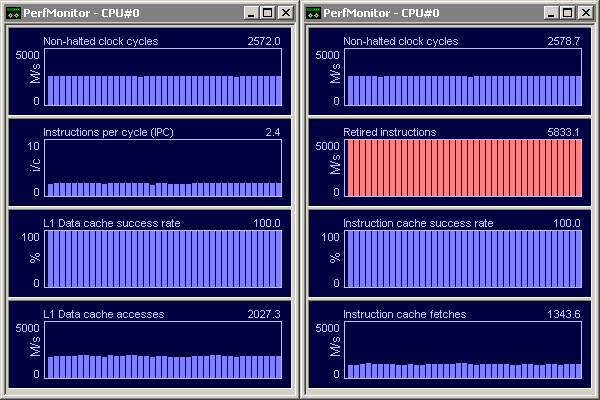

Skeleton of code adjusted to Zen(1) and Zen+ (i. e. placeholder codes omitted).
Runs constantly at 3.4 IPC (of maximum 4.0 due to the 4 available ALU-s) for 50x50 matrices, this means 85% utilization.
Since more than 90% percent of instructions need ALU, so important theorem is the way of instruction distribution among the ALUs. This is true for all other microarchitectures as well.

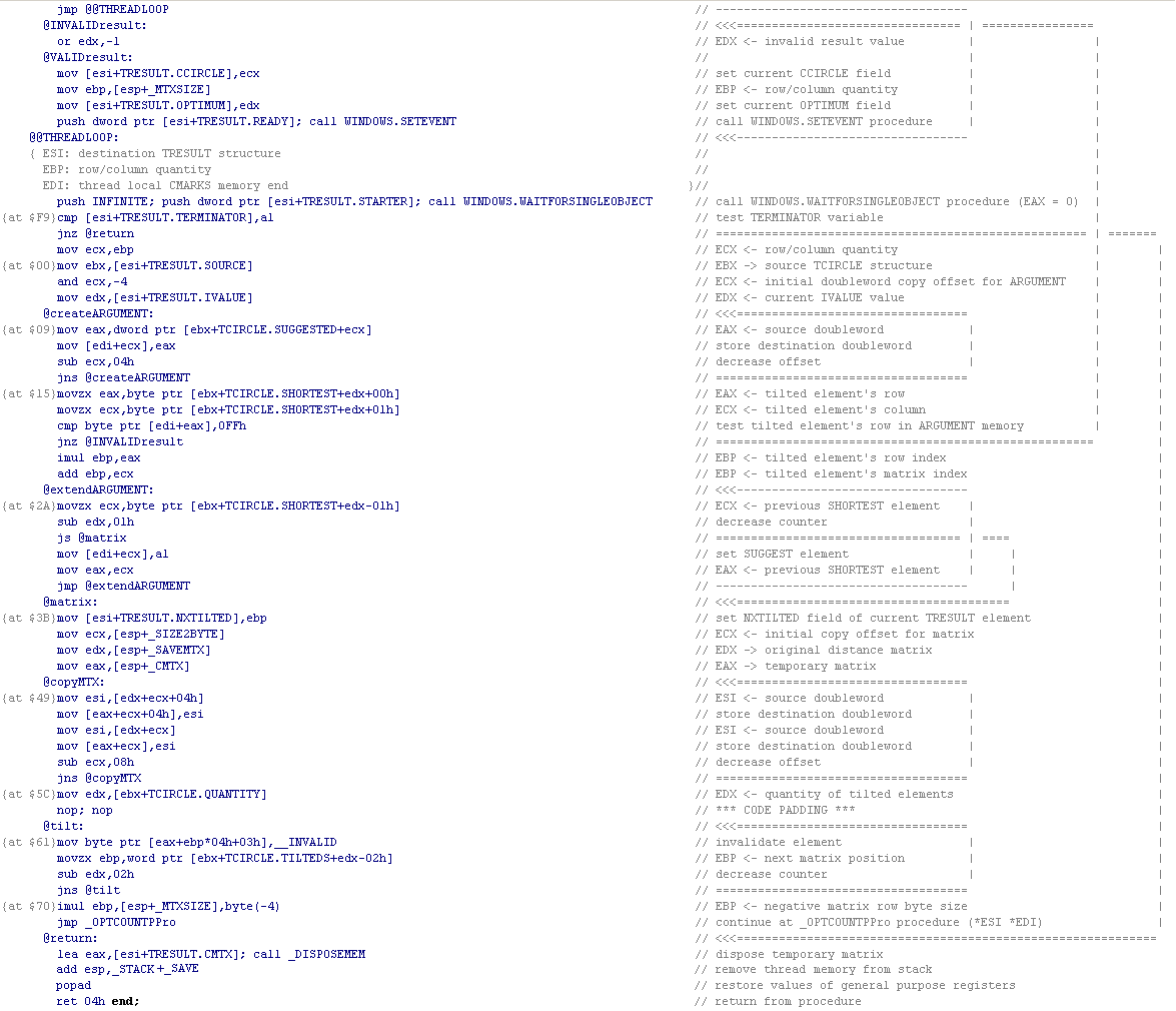

{ } movsx ebx,byte ptr [edx]
{ } xor eax,eax
{ } mov esi,ebp
{ } mov [edi+__N],ebp
{ } and esi,-8
{ } mov ecx,ebp
@init:
{ } mov [edi+esi*08h+(00h*08h)+__K],eax
{ } mov [edi+esi*08h+(04h*08h)+__K],eax
{ } add esi,08h
{ } jnz @init
@argument
{ } cmp ebx.00h
{ } lea eax,[ebp+ebx*04h]
{ } movsx ebx,byte ptr [edx+01h]
{ } lea edx,[edx+01h]
{ } mov [edi+eax*08h+__K],ebp
{ } cmovs eax,esi
{ } mov [edi+ecx*08h+__F],eax
{ } add ecx,04h
{ } jnz @argument
{ } mov [edi+ebp*08h-(04h*08h)+__K],esi
{ } lea edx,[ebp-04h]
{ } mov ebx,edi
{ } jmp @next0row
@ROWS:
{ } mov [edi+__LEFT1+edx*08h+__W],esi
@next0row:
{ } mov eax,[edi+edx*08h+(04h*08h)+__S]
{ } add edx,04h
{ } jz @@COLUMNS
{ } mov [edi+edx*08h+B],eax
{ } xor esi,esi
{ } mov [edi+edx*08h+_R],eax
{ } sub ebx,ebp
{ **} test eax,eax
{ **} jnz @@ROWS
{ } lea ecx,[ebp+04h]
{ } mov esi,[ebx+ebp]
{ } or esi,[edi+ebp*08h+__K]
{ } and ecx,-8
@findrowmin:
{ } mov eax,[ebx+ecx]
{ } or eax,[edi+ecx*08h+__K]
{ } add ecx,08h
{ } cmp eax,ebp
{ } cmovb ebp,eax
{ } mov eax,[ebx+ecx-04h]
{ } or eax,[edi+ecx*08h-(04h*08h)+__K]
{ } cmp eax,esi
{ } cmovb esi,eax
{ **} cmp ecx,00h
{ **} jnz @findrowmin
{ } cmp ebp,esi
{ } cmovb esi,ebp
{ } mov ebp,[edi+__N]
{ } neg esi
{ } jle @@ROWS
@@XXX:
{ } mov esi,[esp+_A]
{ } mov ecx,[esp+_I]
{ } mov dword ptr [esi+A.OPTIMUM],?
{ } mov ebx,[esi+TRESULT.NEXT]
{ } jmp ecx
@free0col:
{ } add dword ptr [edi+__0COUNTER],-1
{ } mov [edi+__CCOLMIN],esi
{ } mov ecx,0FFFFFFFFh
{ } mov [edi+ebp*08h-(04h*08h)+__K],edx
@0col:
{ } mov [edi+__LEFT1+edx*08h+__COLMOD],esi
@@COLUMNS:
{ -} mov ebx,ebp
@next0col:
{ } mov [edi+__LEFT1+edx*08h+__C],ecx
{ } mov ecx,edi+edx*08h-(04h*08h)+__K]
{ } lea eax,[edx-04h]
{ } sub eax,ebp
{ } js @@INIT0COL
{ } sub edx,04h
{ } xor ecx,-1
{ } jns @next0col
@findcolmin:
{ } mov esi,[eax+edi]
{ } add esi,[edi+__LEFT1+ebx*08h+__U]
{ } or esi,[edi+ebx*08h+__S]
{ } jz @test0row
{ } sub eax,ebp
{ } cmp esi,ecx
{ } cmovb ecx,esi
{ } add ebx,04h
{ } jnz @findcolmin
{ } mov eax,edx
{ } lea ebx,[ebp-04h]
{ } mov esi,ecx
{ } cmp ecx,00h
{ } js @@XXX
@seek0col:
{ } mov ecx,[edi+__LEFT1+ebx*08h+(04h*08h)+__W]
{ } sub eax,ebp
{ } add ebx,04h
{ } jz @free0col
{ } add ecx,[eax+edi]
{ **} cmp ecx,esi
{ **} jnz @seek0col
@test0row:
{ } mov ecx,[edi+ebx*08h+B]
{ **} test ecx,ecx
{ **} js @seek0col
{ } mov [edi+ebx*08h+B],edx
{ } mov [edi+edx*08h+__K],ebx
{ } jmp @0col
@@INIT0COL:
{ } lea eax,[edi+ecx]
{ } mov [edi+__L],ecx
{ } neg ebp
{ } sal ecx,10h
{ } jnz @init2col
{ -} xor esi,esi
{ } jmp @@FINISHED
@@5TH_STEP:
{ -} mov edx,esi
{ } movsx esi,si
{ } sar eax,10h
@5TH_STEP:
{ } movsx ecx,byte ptr [edi+__LEFT1+ebx*08h+__SIGN+__C]
{ } and ecx,edx
{ } add [edi+__LEFT1+ebx*08h+__COLMOD],ecx
{ } movsx ecx,byte ptr [edi+ebx*08h+__SIGN+_R]
{ } and ecx,edx
{ } add [edi+__LEFT1+ebx*08h+__W],ecx
{ } add ebx,04h
{ } jnz @5TH_STEP
{ } mov edx,es:[edi+esi*08h+B]
{ } db $8B,$8C,$3B,__L,?,?,?
{ **} test edx,edx
{ **} jz @@4TH_STEP
{ } add dword ptr [edi+__PN],-1
{ } mov [edi+esi*08h+_R],eax
{ } mov [edi+__LEFT1+edx*08h+__C],esi
{ } cmp edx,ecx
{ } cmovb ecx,edx
{ } sub ebx,ebp
{ } jmp @@9ND_STEP
@fast6forward:
{ } mov esi,[edi+__LEFT1+ebx*08h+(04h*08h)+__W]
{ } add ebx,04h
{ } jz @pass8col
{ } sal ecx,10h
{ } jmp @loop
@pass8col:
{ } mov eax,[edi+__N]
{ } sub ebx,ebp
{ } mov [edi+__LEFT1+ecx*08h+__C],eax
@next20col:
{ } add ecx,04h
{ } jz @@5TH_STEP { clears ECX register
{ **} cmp [edi+__LEFT1+ecx*08h+__C],eax
{0**} jbe @next20col
@@8ND_STEP:
{ } mov esi,[edi+__LEFT1+ecx*08h+__COLMOD]
{ } mov [edi+__CCOL],esi
{ } imul ecx,00010000h
@init2col:
{ } add eax,ebp
{ } mov esi,[edi+ebx*08h+__W]
@loop:
{ } sub esi,[edi+__COLMIN]
{ } add esi,[eax]

@character:
{@65} { } mov [edi],al
{ } add edi,01h
@@DECODE:
{@6A} { } mov eax,[esp+_aMAXMINBITS]
@read_raw: { BPOS may be 20h since decreased soon }
{ } movzx ebp,byte ptr [esi]
{@70} { -} mov ecx,edx
{ } sub edx,(24+1)
{ } shl ebp,cl
{ } shr edx,1Fh
{ } add esi,edx
{ } lea edx,[ecx+edx*08h]
{ } or ebx,ebp
{@81} { **} cmp dl,al
{ **} jb @read_raw
@createABCcode:
{ } movzx ebp,bl
{ } movzx ecx,bh
{ } shr eax,10h
{ } { x1 } mov ebp,dword ptr es:[REVERSE2hi+ebp*04h]
{ } { x1 } add ebp,dword ptr es:[REVERSE2lo+ecx*04h]
{ -} mov ecx,eax
{@A0} { } mov eax,offset(EXT_AMINMAXCODE)
@seekABC:
{@A5} {0**} cmp [eax+ecx*08h+00h+_MAX],ebp
{1**} jnbe @foundABC
{2} cmp [eax+ecx*08h-08h+_MAX],ebp
{0} lea ecx,[ecx-02h]
{@B1} {1} jbe @seekABC
{ } add ecx,01h
@foundABC:
{@B6} {0} mov eax,[eax+ecx*08h+_MIN]
{1} shr ebp,cl
{2} { x1 } mov eax,es:[eax+ebp*04h]
{@C0} {0} neg ecx
{1} add ecx,10h
{2} sub edx,ecx
{0} shr ebx,cl
{1**} cmp eax,255
{2**} jna @character { SHORT jump instruction offset: -6Bh }

Nincs többé külön K10-nek tetsző és külön Core2-nek tetsző verzió: egyetlen van, amely mindkettőn jó, kb. 0.5% veszteséggel.
Core2 (2.5 GHz): 58 sec alatt megoldja a feladatot
K10 (2.9 GHz): 44 sec alatt megoldja a feladatot
Prescott (2.26 GHz): 60 sec alatt 220000 mátrix

P.H.
Továbbra is egy szálas program.
Core2 (2.5 GHz): 60 sec alatt 507000 mátrix
Sandy Bridge (G1620 2.7 GHz): a K10-es ciklusverzióval 59 sec, a Core2-essel 60 secAkkor is meg fogja oldani 2500 MHz-en bármely Core egy szálon ezt a feladatot; ha kell, fél évig mászok fel hetente 1000 mátrixot, de meg fogja.

A "simítások" célja - ha nem lenne egyértelmű - az IPC növelése; ez jórészt sikerült is. Ezen szakaszban az algoritmikus megoldások már tisztázottak, a lényeg, a minél kevesebb utasítás + minél több mellékhatás = minél kevesebb órajel alatt tegye meg ugyanazt a CPU. És itt jönnek ki leginkább a microarch. különbségek és főleg a gyengeségek. Azaz az utasítássorrend.
Szem előtt mindig azt tartom, hogy a kód legyen mindenen jó, ne legyen egy kiszemelt microarch, amin jól fut, a többi rovására, de a lehető legkevesebb kompromisszummal.
Ivy Bridge (3.8 GHz): 43 sec alatt végez a teljes feladattal
P4 Northwood (2.4 GHz): 60 sec alatt 225000 mátrix
Kaveri (3.8 GHz): 54 sec alatt végez a teljes feladattal
Core2 (2.5 GHz): 60 sec alatt 463000 mátrix
K10 (2.9 GHz): 48 sec alatt oldja meg a teljes feladatotMint látható, Ivy Bridge-en és a Northwood-on gyorsabb lett a program, a Kaveri-n nem változott a lefutás sebessége (a fő korlátozó tényező még mindig a 2 db EX);
Core2-n lassabb lett, K10-en viszont "fénysebességre" kapcsolt, folyamatos 2.6 IPC-vel fut le a korábbi 2.4-gyel szemben. Az ok is megvan: az utasítássorrend. A program "mindent vivő", fő meghatározó ciklusa:

P.H.
Simitgatva:
K10 (2.9 GHz): 53 sec alatt oldja meg a teljes feladatot
Ivy Bridge (3.8 GHz): 45 sec alatt végez a teljes feladattal
Core2 (2.5 GHz): 60 sec alatt 479000 mátrix
P4 Northwood (2.4 GHz): 60 sec alatt 221000 mátrixCore-családhoz kis adalék:
PerfMonitor Record file
Counter 0 : Non-halted clock cycles
Counter 1 : Instructions per cycle (IPC)
Counter 2 : Retired fused uops
Counter 3 : Retired non-fused uops
T(ms) c0(M/s) c1(i/c) c2(M/s) c3(M/s)
50 2500.0 2.2 1323.7 4871.0
100 2500.0 2.1 1312.8 4842.1
150 2500.0 2.1 1312.8 4843.9
200 2500.0 2.1 1305.8 4808.1
250 2500.0 2.2 1322.9 4882.0
300 2500.0 2.2 1324.7 4874.4
350 2500.1 2.1 1301.2 4800.0
400 2499.9 2.1 1317.3 4851.5
450 2500.0 2.1 1317.9 4858.3
500 2500.0 2.1 1316.3 4849.7Ez a 2.5 GHz-es Core2 mérése:
- ami nem látszik, 2.1 IPC mellett 2.5 uop/cycle (cmovcc...)
- ami látszik: stabilan 4800 feletti non-fused és 1300 feletti fused uop/cycle (utóbbi 2 végrehajtót dolgoztat), azaz 4800+1300*2 = 7400, a branch misprediction-ok mellett is minden órajelben 3 feldolgozó dolgozik a 6-ból.{@08} { x1 } and eax,00h

@@5TH_STEP:

P.H.
Titkon, álmomban reméltem, hogy eljön ez a pillanat, de nem volt valós alapja. De(!) eljött.
Core2 (2.5 GHz): 60 sec alatt 344000 mátrix
K10 (2.9 GHz): 60 sec alatt 450000 mátrix
Ivy Bridge (3.8 GHz): nem mérhető, 53 sec alatt megoldja a feladatot (a teljes lefutást 510000 mátrix kiszámolása jelenti); ez több, mint 13%-os gyorsulás a legutóbbi programhoz képest; számításaim szerint 60 sec alatt kb. 570000 mátrixot oldana meg a 3770K.
Nem kérdés,új tesztfeladatot kell keresni, most jöhet a többszálú algoritmus újraelkészítése.A store-to-load forwarding kulcskérdéssé vált, az @@5TH_STEP két egymást követő ciklusa részben azonos elemeken dolgozik, mindkettő load-op-store műveletekkel.
Ez a program nagyon meghálálja, ha órajelenként két jcc feltételes ugrás kerülhet végrehajtásra; erre a K8/K10-en kívül egyedül a Haswell képes. El se merem képzelni, ott mit mutatna...
A Pentium 4-eken természetesen lassult így a program a write-through L1D miatt; a 3.8 GHz-es Kaveri-n (ugyancsak write-through L1D) legutóbb 425000 mátrix volt az eredmény 60 sec alatt, tehát hozta a 2.9 GHz-es K10 sebességét 31%-kal nagyobb órajelen, 2 EX végrehajtóval; azt, hogy az ez a kód mit tud, még nem tiszta, de első látásra gyorsabb nem lett.
Mint látható, számos utasítás mellékhatása erőteljesen ki van használva (egy ciklus nulláz egy regisztert, shift utasítás CF-be teszi az utolsó kitolt bitet, jmp helyett feltételes ugrás egy sosem létrejövő értékre, ...) az utasításszám csökkentése végett. Ez most így K10-en 2.2 IPC.

Mint a zipzár, az alábbi kód úgy zárt össze a K10 és a Core2 fogaskerekeivel.
Core2 (2.5 GHz): 60 sec alatt 290000 -> 308000 mátrix
K10 (2.9 GHz): 60 sec alatt 390000 -> 428000 mátrix
Ivy Bridge (3.8 GHz): 60 sec alatt 480000 -> 497000 mátrixA tesztfeladat teljes lefutásához ~565000 mátrix megoldására van szükség; már nincs messze, hogy valamelyiken 60 sec alatt meglegyen.
Sikerült újra elérni a K10-en a lefutás alatti folyamatos 2.3-2.4 IPC-t, illetve Core2-n a 2.2 IPC-t (ami a ciklusonkénti legalább 1 cmovcc miatt ~2.5-2.6 fused uop/clock); illetve a Core2 miatt eliminálásra került az összes load-op-store művelet a ciklusokból, meg is hálálta.A K10-ben rengeteg potenciál van (3 ALU, 2 L1D-olvasás/clock, cmovcc=1 uop, 3 clock L1D-latency), csak nagyon nehéz eltalálni a megfelelő decode miatti utasításelrendezést (a K8-on 2 db 16 byte-os instruction buffer volt az L1C után, a K10-ben viszont egyetlen 32 byte-os buffer van), illetve azt, hogy a "számítási" utasítások ne ütközzenek a 3 ALU-ban a statikus leosztás miatt (itt főleg a sok movsx reg,mem okoz gondot).
A Core2 attól szenved, hogy a cmovcc utasítások nemcsak hogy 2 végrehajtót igényelnek, de az utasításdekódolást is befolyásolják, mert ezen utasítások csak az első dekóderbe mehetnek, a 4-1-1-1 minta szerint, ezért a legtöbb 8 utasításos ciklus is csak 3 órajel alatt dekódolható.
A Bulldozer-alapú CPU-k is szenvednek a K10-hez képest, ott viszont az a gond, hogy magonként csak 2 számítási végrehajtó (EX0 és EX1) van a két AGU mellett (míg K7-ben, K8-ban, K10-ben, Core2-Ivy Bridge-ben 3, Haswell-ben 4), ebbe kell beletuszkolni a 8 utasításos ciklusok 7-8 számítási uop-ját, ezért ezek lefutása nem tud kevesebb lenni, mint 4 órajel; ehhez viszont kevés a ~4 GHz órajel, 1.5x akkora frekvencia kellene, mint a K10-nél (vagy legalább egy igazi AGLU).
Az Ivy Bridge kiegyensúlyozottan teljesít, az uop-cache miatt a dekódolás nem szűk keresztmetszet és a kódban elég sok macro-op fusion is van, de azért a folyamatos, garantált 4 uop/clock kicsit sovány a Core 2 4-1-1-1 mintájából kinyerhető 7 uop/clock-hoz képest. Mindenesetre itt a legkisebb a nyereség, mi azt mutatja, hogy alapvetően itt volt a legnagyobb a hatékonyság.{0-} mov ecx,esp

{2*} jnz @@resultsA legutolsó mért eredmény 25x25-ös mátrixra 71000/sec, a fenti kód most 105000 mátrix/sec az azonos tesztadatra (+47,8%).
P.H.
A gulács megszá'tta a lélkömet, oszt' ezör fontosabb dolgom volt eddig, mint hajlítani ezen a programon.
De "új év, új szemlélet", hülyébbek meg nem lettünk, szóval ugyan kisebb IPC, de okosabb megközelítés.
Van benne egy csomó NOP is, az arra fogékonyak kedvéért.
Sebességnövekedés:
Pentium 4: +6%
K10: +20,5%
Core2 +32,4%xor ebx,ebx

@@results:
{@D7} mov eax,[edi+ecx*04h+__0STAR]
{1} sub ebx,ebp
{2} add edx,[ebx+eax]
{@E0} sub eax,ebp
{1} shr eax,02h
{2} mov [esi],al
{0} lea esi,[esi+01h]
{1*} add ecx,04h
{2*} jnz @@results
{@F0} ... -

{ x2 } nop; nop
@@CHECKRESULTS:
{align $29} add [CIRCLEVAR],ebx
mov ebx,offset(TSP30)
mov ebp,offset(TSP30.RESULTS)
mov edi,[ebx+TTSP30.COLLECTOR]
@@AFTERCIRCLE:
mov eax,[esp+_BASEELEMENT+TCIRCLE.QUANTITY]
{ x1 } nop
@@HEADMATRIX:
{align $40} mov esi,[ebx+TTSP30.ENTRY]
@next:
cmp ebp,[esp+_CDEST]
ja @@NEXTMATRIX
mov ecx,[ebp+TRESULT.OPTIMUM]
{align $50} add ebp,TRESULTSIZE
{ x1 } nop
cmp ecx,[ebx+TTSP30.GLOBALOPTIMUM]
jae @next
mov edx,[ebp-TRESULTSIZE+TRESULT.CCIRCLE]
cmp edx,[esp+_MTXSIZE]
{align @60} jz @@CIRCLE0
{ x1 } nop
cmp dword ptr [edi+TCIRCLE.NEXT],00h
jz @@PLUSMEM
@enqueue:
add dword ptr [ebx+TTSP30.MEMORY],01h
{align $70} cmovnz esi,[edi+TCIRCLE.NEXT]
{ x1 } nop
cmovnz edi,esi
mov [esi+TCIRCLE.RESULT],ecx
movzx ecx,dl
shr edx,08h
{align $80} lea ebx,[esi+TCIRCLE.SHORTEST+ecx]
neg ecx
mov [ebx],dl
@shortest:
mov [ebx+ecx],dl
movzx edx,byte ptr [ebp-TRESULTSIZE+TRESULT.ORDERSET+edx]
{align $90} add ecx,01h
jnz @shortest
movzx edx,byte ptr [esp+_BASEELEMENT+TCIRCLE.SHORTEST+00h]
lea ebx,[eax-TCIRCLE.QUANTITY]
shr ebx,03h
@clone:
{align $A0} mov eax,[esp+_BASEELEMENT+ebx*08h+04h+TCIRCLE.QUANTITY]
mov [esi+ebx*08h+04h+TCIRCLE.QUANTITY],eax
mov eax,[esp+_BASEELEMENT+ebx*08h+00h+TCIRCLE.QUANTITY]
mov [esi+ebx*08h+00h+TCIRCLE.QUANTITY],eax
{align $B0} dec ebx
jns @clone
mov ebx,[ebp-TRESULTSIZE+TRESULT.NXTILTED]
mov [esi+eax-02h],ebx
lea ebx,[TSP30]
@suggest:
{align $C0} cmp ecx,[ebp-TRESULTSIZE+TRESULT.IVALUE]
jae @@HEADMATRIX
movzx ebx,byte ptr [esp+_BASEELEMENT+TCIRCLE.SHORTEST+ecx+01h]
add ecx,01h
mov byte ptr [esi+TCIRCLE.SUGGESTED+edx],bl
mov edx,ebx
jmp @suggest
{align $DE} { x3 } nop; nop; nop
{ x8 } nop; nop; nop; nop; nop; nop; nop; nop
@@PLUSMEM:
{align $E9} lea eax,[ebx+TTSP30.WORKAREAS]; xor edx,edx; call _ADDINT
mov edx,[ebx+TTSP30.STRUCTURESIZE]; mov ecx,3000; call _REALLO
{align $00} add [ebx+TTSP30.COLLECTED],ecx
dec ecx
@setmem:
{align $04} mov [eax+edx+TCIRCLE.NEXT],eax
add eax,edx
sub ecx,01h
jnz @setmem
{align $0E} mov edx,[ebp-TRESULTSIZE+TRESULT.CCIRCLE]
mov ecx,[ebp-TRESULTSIZE+TRESULT.OPTIMUM]
mov [edi+TCIRCLE.NEXT],eax
jmp @enqueue
{ x1 } nop
@@CIRCLE0:

- a szintén paraméterként EDX-ben megkapott leírás bárhol lehetElsősorban a 4 utasítás/órajel dekódolóképességű CPU-kat vettem figyelembe (Core2 és újabb Intel CPU-k, Bulldozer), de adott órajelen a Sandy/Ivy Brigde-en a leggyorsabb, a K10-es Opteron a 2. a sorban, Core2-őn kb. 15-12% a lemaradás.
60x60-as mátrixon tesztelve jellemzően 2.4 IPC:
- az egyszálas algoritmus lefutása K10-en
- a többszálas algoritmus - egy magra kényszerítve - lefutása K10-enA Core2-k ciklusfelismerése nagyon rendben van: "A branch instruction is recognized as having loop behavior if it goes one way n-1 times and then goes the other way one time. A loop counter makes it possible to predict branches with loop behavior perfectly if the period nis no longer than 64." Mivel maximum 60 x 60-as mátrixokról van szó, a branch prediction success rate Core2-n 99.5%; K10 esetében 98.5% körül mozog, sajnos Sandy Bridge-nél is: "There appears to be a two-level predictor with a 32-bit global history buffer and a history pattern table of unknown size. There is no specialized loop predictor."
Az Intel-eket többé-kevésbé visszahúzza a CMOV és a load-op-store utasítások 'lassú' kezelése: ez elsősorban ezen utasítások lassú dekódolása miatt van (Core2), de a Sandy Bridge esetében igen nagy az előrelépés ezen a téren. (Arra viszont jó lenne fényt deríteni, hogy a Sandy Bridge uop-cache-e hány uop-ot tud a végrehajtó egységekhez juttatni órajelenként: úgy tűnik, a 4 nem igaz, 5 vagy 6 a valóság, észben tartva, hogy a raw dekóder 4+1+1+1 = 7-et tud szolgáltatni).
In Haswell we trust...A futásai idő mostmár 60%-a a @decrease_row_free ciklusban, és immár csak 25%-a a @zeroincol ciklusban megy el; a maradék a többi kód és az (itt nem leírt) adminisztráció.
A fent leírt jelölés + mátrix memóriaelrendezést alkalmazva egy 60x60-as mátrix 15KB összefüggő memóriaterületet igényel, ez megfelel minden modern CPU-nak.
Core2 óta minden Intel CPU-ban van LSD/loop-puffer az utasításoknak; K10 esetében nincs. Viszont ez sem helytálló teljesen: "The minimum execution time per iteration for a loop is approximately equal to the number of 32-byte boundaries on K10, or 16-byte boundaries on K8, in the code plus 2 times the number of taken branches and jumps."
K10-en ha egy rövid ciklus 3-többszöröse (3-6-9) utasításból áll, akkor nincs helye játéknak, bele kell férnie egy 32 byte-os területbe. Viszont úgy veszem észre, hogy ha kevesebb (4, 5, 7, 8) utasításból áll a ciklus, akkor a $10-re alignált utasítások nem okoznak késleltetést, viszont új hármast kezdenek; ezzel a statikus 3-as utasításleosztást lehet befolyásolni (lásd @decrease_row_free ciklust: egyetlen 32 byte-os egységbe rendezve lassabb a 8 utasítás lefolyása, mintha az első utasítás $3A-ra - azaz a 3. utasítás $40-re, ezzel indul a következő triplet - van rendezve, így a 3 integer-pipe más utasításokat kap meg, amelyek nem akadályozzák egymást).
Az utasítások/ciklusok rendezésének (alignálásának) hiánya vagy figyelmen kívül hagyása 15-20% visszaesést jelent a K10-es teljesítményben. -

Egy, az algoritmus által adott lehetőséget kihasználva (a szabad 0 keresését - @@2ND_STEP - nem kell mindíg a mátrixban elölről kezdeni) az egyszálas 25x25-ös mátrixszámítás tempóját sikerült 69,5 mátrix/ezredmásodpercre feltornászni.
PerfMonitor egyszálas elemzés az új kódra alapuló teljes lefutásról a maximális 60x60-as mátrixméretre: K10-en sikerült ráérezni a hardware prefetcher-ekre, szinte a teljes lefutás (a tesztadaton 1,5 perc) tisztán L1I-ből és L1D-ből fut (cache success rate 100%).
