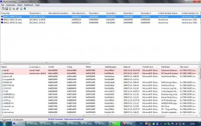

Helló, a BIOS-t mindjárt megnézem, közben ezt megmutatnám :
A Windows szerint :
Video Hardver Hiba.
Tegnap egyébként Prime95-t is futtattam, végig stabil volt.

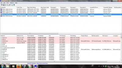

bluescreen
Fire/SOUL/CD
#753
Analysis
--------------------------------------------------------------------------------Crash dump directory: E:\WINDOWS\Minidump
Crash dumps are enabled on your computer.
On Sat 2009.10.10. 13:30:52 your computer crashed
This was likely caused by the following module: ntoskrnl.exe
Bugcheck code: 0x7A (0xC03DDC94, 0xC000000E, 0xF7725F2F, 0x7EEF860)
Error: KERNEL_DATA_INPAGE_ERROR
file path: E:\WINDOWS\system32\ntoskrnl.exe
product: Microsoft® Windows® operációs rendszer
company: Microsoft Corporation
description: NT - kernel és rendszer
The crash took place in a standard Microsoft module. Likely the culprit is another driver on your system which cannot be identified.--------------------------------------------------------------------------------
Conclusion
--------------------------------------------------------------------------------1 crash dumps have been found and analyzed. Note that it's not always possible to state with certainty whether a reported driver is really responsible for crashing your system or that the root cause is in another module. Nonetheless it's suggested you look for updates for the products that these drivers belong to and regularly visit Windows update or enable automatic updates for Windows. In case a piece of malfunctioning hardware is causing trouble, a search with Google on the bug check errors together with the model name and brand of your computer may help you investigate this further.
Futtattan WhoCrashed -et és ezeket irta ki nekem.
Mit jelent ez??
