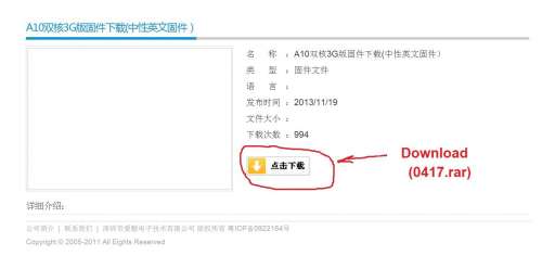

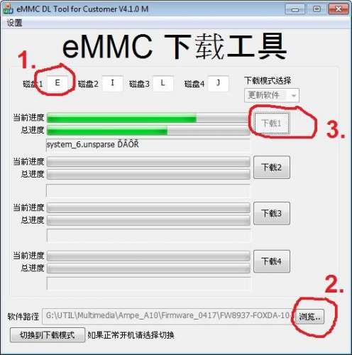

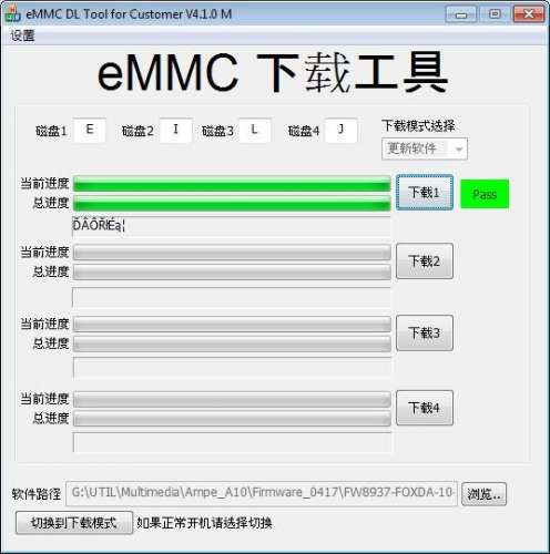

Firmware frissítés EMMC Tool-lal:
http://www.slatedroid.com/topic/49802-ampe-a10-3g-tab-latest-firmware-please/page-2
1. Connect the USB cable to the Computer
2. Power off your device
3. Connect the other end of the cable to the Tablet PC
4. Now press power + volume up and down buttons ( all together )
5. Now it will ask you to install drivers --- for windows XP continue install hardware and direct to the folder 0289 -- - ???? --- drivers. For win 7 go to the device manager and find other devices with a question mark. Right click and update software - - - direct to ???? --- drivers
6. After succesful installation of the driver, you will get an extra drive in my computer. Check the name of the memory mass storage drive and remember it.
7. Now open the eMMC tool (http://www.mediafire.com/download/ifb30haupg3zrn7/eMMC_DL_TOOL.rar)
8. After opening click the first drive on the upper part of the eMMc tool and change the first letter to what you find in the My Computer as mass storage.
9. At the lower part of the eMMC tool, browse, and direct towards 0417 (FW8937-FOXDA-10-V4.7.2.0-V003-20130820)
10. Now click on the first options with # 1
11. That is all...

but when I start the EMMC-tool I get the error 'License expired' and when I try the Emmc-tool from 0288 I get the message 'Invalid User'1- with regedit delete this key: HKEY_LOCAL_MACHINE\SOFTWARE\FOXDA
2- delete this file c:\windows\system32\emmc_date.ini
3- on the pc change the data to 20 march 2013 (the program works until 30 march 2013)
4- run program--------------------

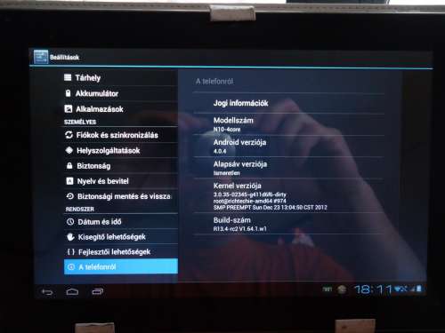

Nos. Tehát nekem egy Sanei N10 quad core tabletem van.
Ehhez, akkor amit írtatok, letöltöttem az alábbiakat:
recovery-clockwork-6.0.3.6-a10 (ez vmi képfájl)
A10_N10_v1.64.W1-v3.4_signed (ez pedig tömörített fájl) --> ez egyébként akkor önmagában egy szoftver?Lássuk jól értem-e, amit kitudtam bogarászni; frissítenem kell a recoveryt (erre megfelel amit letöltöttem?), ha ez megvan, akkor a friss recoveryt elindítva, telepíteni tudom az új ropogós szoftvert (azt a tömörített fájlt). Igaz? Tehát nem kell semmilyen segédprogram stb., csak ez a két lépés.
Na most, pontosan, hogyan frissítem a recoveryt? Mihez kell kezdenem azzal a képfájllal? Majd a romot hova kell másolnom, hogy települjön? Így tömörítve, vagy ki kell csomagolni a telepítéshez?

Hát pfff...próbáltam én ma mindent. Volt Nexus 7, SGS2, Allwinner de nem működött semmivel. Tipped esetleg van, hogy milyen helyes beállításokkal működhet a play? Ha nincs, tudod esetleg, hogy melyik szakmai topicban tehetném fel a kérdést?
Az eddigi segítséged nagyon köszönöm, hasznosak voltak, sikerült megoldani a problémát. A jövőben majd még egy sor kérdést tennék fel szoftverfrissítéssel kapcsolatosan is.
yetir
Letöltöttem a Build Prop Editor appot, ennek segítségével sikerült átírni az általad említett sorokat. Ezután újraindult, majd töröltem a Play adatait és a cachet, és megint újraindítottam. Viszont pl. a Simpson játékra továbbra is azt írja, hogy nem kompatibilis.
A samsung adatokat írtam be, gondoltam próba szerencse. Viszont találtam még egy sort a ro.product.manufacturer=Freescale, nem lehet, hogy ezt is át kell még írni? Vagy esetleg lehet, hogy akkor más eszköz adatait kell beírni? Ha igen, nem tudsz ebben segíteni, hogy mégis melyik hasonló tablettel azonos a Sanei? Minek kell megfelelnie? Csak felbontásnak, vagy milyen paramétereknek pontosan? Ajánlani tudsz esetleg valamit?

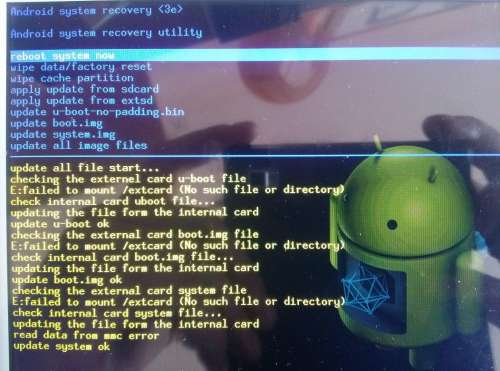

icsnaj
Helló Mindenkinek!
Kb. 1 éve az itt olvasott infók alapján vásároltam 1 Ampe A 10. 4 magos tab-ot (1,62b-vel van.. A feleségem használta többnyire és az idén Jan-tól minden progiból kilépkedett....,stb. A barátom is próbálta és Én is most a napokban frissíteni pl. 1,64w1-re vagy R1-5 City Ace Aver....,stb.
Az SRS root progi lefutott és azt írta Rootolva.
A probléma most indult a külső extsd kártyáról nem volt hajlandó frissíteni (1 kép.), ekkor bemásoltam (pc-re kötve) a belső sd gyökerébe. Itt szépen végig vitte a folyamatot és System update ok írással nyugtatott. Ezután Reboot System Now és a 2. képen látható bootolást végzi de nem tudja befejezni. Már mást nem tudok rátenni , mert a külső sd-t nem látja a belső sd-hez meg nem tudok hozzáférni pc-vel (mindig a belsőre másolt fw-t frissíti).
Nagyon megköszönném ha valaki tudna segíteni! Számítok a tapasztalaitokra! Kösz -

Leírtam korábban, de ha Write-only módban ragadtál, akkor nem fog menni.
Legjobb tudásom szerint az EMMC Toollal lehet förmvert frissíteni ezekhez az eszközökhöz (talán még a Livesuit-tal is?), amelynek csomagjában benne van az USB-driver.
Tehát, az EMMC Tool letöltése után (lásd korábbi hsz-em):
1. dugj be egy mikro USB kábelt a PC-be
2. kapcsold ki a tabletet
3. csatlakoztasd az usb kábel másik végét a tabletre
4. nyomd meg egyszerre Ki/bekapcs + hangerő fel/le gombokat
5. Win XP-nél a rendszer (PC) kéri, hogy telepítsd az usb drivert.
Mutass az EMMCTool USB almappájára, pipáld be a Keresés almappákban is opciót.

Ampe A10 3G 10" kétmagos tablet firmware frissítése Android 4.0.4-ről 4.1.2-re
1. Töltsd le a legújabb firmware-t innen.
2. Töltsd le az EMMC Toolt, amellyel frissíteni tudod a firmware-t innen.
3. Kösd össze a tabletet a PC-vel egy USB-kábellel. Ha minden OK, a PC-ben megjelenik egy új meghajtó (pl. E betűjellel). Ha nem jelenik meg az új meghajtó, telepíteni kell a Qualcomm CDMA Technologies MSM Drivert.
Ezeket a fájlokat olyan mappába tedd, amelyek elérési útjában csak angol betű szerepel. A kicsomagolt RAR fájlok után létrejövő mappákat nézd át, és törölj a fájlnevekből mindenféle kínai jelet is mindenütt, csak az angol betűk maradjanak meg.
4. Állítsd át a PC óráját 2013.03.30. előtti dátumra.
5. A regedit segítségével töröld a HKEY_LOCAL_MACHINE\SOFTWARE\FOXDA kulcsot.
6. Töröld a c:\windows\system32\emmc_date.ini vagy emmc_update_error.ini vagy hasonló nevű fájlokat.
7. Indítsd el az EMMC Toolt.
8. Add meg a 3. pontban említett meghajtó betűjelét balra fent az első dobozban, majd lent válaszd ki a fimrware mappáját, és utána kattints a képen látható 1-es gombra.
Ekkor elindul a firmware-frissítés, amely pár perc múlva véget ér, és a Pass jelenik meg.

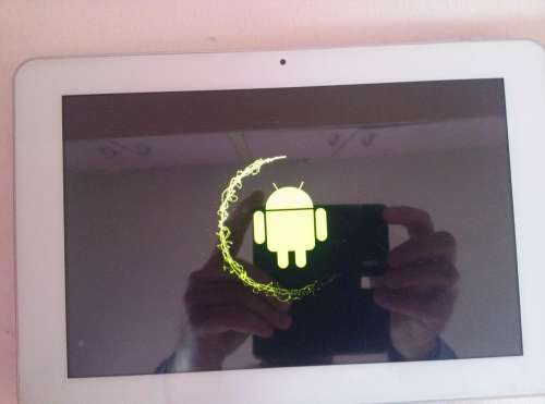

Húzd ki az USB-kábelt, nyomd meg a tablet hátán a kis lyukban a Reset gombot, és hagyd, hogy a tablet újra induljon!
Megjelenik egy kis droid, majd utána az android felirat. A csúnya kínai jelek már nem jelennek meg. Voilá! -

Viszont fontos dolog hogy az itt található recovery-clockwork6.0.3......-ra kell cserélni mert a régi recoveri-vel nem megy fel a frissítés.
Az ehhez tartozó perancssor a terminal emulátorban a következő:
az első az su ekkor ha rootolt a gép engedélyt kell ani a terminal emulátornak!
A következő parancs csak akkor él ha ezt az engedélyt megkapta!
app_45@android:/ $ sua root jog engedélyezve!
root@android:/ # dd if=/sdcard/recovery-clockwork-6.0.3.1-a10.img of=/dev/block/mmcblk0p2
12360+0 records in
12360+0 records out
6328320 bytes transferred in 7.371 secs (858542 bytes/sec)
root@android:/ #Ha ez megvan akkor a A10_N10_v1.64.W1-v3.2_signed.zip (akinek W2 képernyője van annak a másik file) file-t bemásolod a belső sd kártya gyökerébe és újraindítod a szokásos volume- +power gombbal ha sikerült akkor egy új kép fogad itt kiválasztod install zip from sdcard menüt megkeresed a ferakott file-t és telepíted!
újraindítod és örülsz! Akkumulátor idő megnyúlt a teszt eredménye folyamatosam 12000 pont fölött van. A programok stabilan gyorsan futnak.

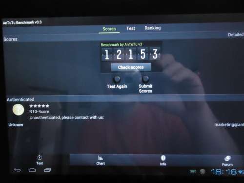

Sikerült kiderítenem, hogy mi lehet a képernyő sader hiba. Nos ez nem más mint az apk maga! Nem hagyott nyugodni a dolog és felraktam újra és elkezdtem tesztelni hogy mivel megy és mivel megy de rosszul. Arra jutottam, hogy ugyanabból a pl játékból az egyik verzió megy rendesen a másik meg sader hiányos. Tehát megint kiderült amit régen is tudtam hogy nincs "mindenható" olcsó táblagép de még drága sem!
Most jelen állás szerint rendszertakarítás után a V1.64 w1 firmware azt hiszem a legutolsó van rajta root megvolt ~2perc és működik rendesen. A need for speed most wanted sokkal gyorsabb rajta mint az előző verzióval a sebességmérő és a környezet sebessége elég közel áll egymáshoz. Megszünt az az élmény hogy 200km/h-nál 80km/h élmény!
Antutu teszt 12000 pont, azért az eredetihez képest 30% sebesség növekedés anélkül, hogy a hardver részt túlhajtottuk volna. Viszont egy tanács ha ezt a firmware-t használja valaki érdemes root jogot erőltetni! Mivel minden nem kívánatos alkalmazást le kell gyalulni róla mint: telefon, kínai gagyik, hálózatkeresés, ezek mind nyalják rendesen az akkumulátort.
Este teszek fel képet a teszt eredményről hátha valaki azt hiszi csak szédítem.......... -

Aki letölti és felrakja számoljon azzal, hogy a sebesség megnő, az boot idő valamit csökken, VISZONT hiba van a 3D megjelenítésben!
Ez úgy néz ki, hogy ANTUTU 12000 pont felett!! a boot idő 30mp alatt!
