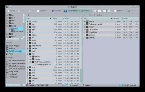

És azt honnan? Itt csak az van, amit most is használok.
(#16169) sh4d0w: Oda is bemásoltam már, semmi változás.

root@leonard:/home/gz# ldd /home/gz/.mozilla/plugins/libflashplayer.so
linux-vdso.so.1 => (0x00007fffeb3ff000)
libgthread-2.0.so.0 => /usr/lib/libgthread-2.0.so.0 (0x00007f646047e000)
libX11.so.6 => /usr/lib/libX11.so.6 (0x00007f6460143000)
libXext.so.6 => /usr/lib/libXext.so.6 (0x00007f645ff30000)
libXt.so.6 => /usr/lib/libXt.so.6 (0x00007f645fccc000)
librt.so.1 => /lib/librt.so.1 (0x00007f645fac4000)
libXcursor.so.1 => /usr/lib/libXcursor.so.1 (0x00007f645f8b9000)
libXrender.so.1 => /usr/lib/libXrender.so.1 (0x00007f645f6af000)
libssl3.so => /usr/lib/libssl3.so (0x00007f645f47f000)
libsmime3.so => /usr/lib/libsmime3.so (0x00007f645f258000)
libnss3.so => /usr/lib/libnss3.so (0x00007f645ef55000)
libnssutil3.so => /usr/lib/libnssutil3.so (0x00007f645ed39000)
libplds4.so => /usr/lib/libplds4.so (0x00007f645eb35000)
libplc4.so => /usr/lib/libplc4.so (0x00007f645e931000)
libnspr4.so => /usr/lib/libnspr4.so (0x00007f645e6f3000)
libpthread.so.0 => /lib/libpthread.so.0 (0x00007f645e4d6000)
libdl.so.2 => /lib/libdl.so.2 (0x00007f645e2d2000)
libgtk-x11-2.0.so.0 => /usr/lib/libgtk-x11-2.0.so.0 (0x00007f645dcb1000)
libgdk-x11-2.0.so.0 => /usr/lib/libgdk-x11-2.0.so.0 (0x00007f645da03000)
libatk-1.0.so.0 => /usr/lib/libatk-1.0.so.0 (0x00007f645d7e2000)
libpangoft2-1.0.so.0 => /usr/lib/libpangoft2-1.0.so.0 (0x00007f645d5b8000)
libgdk_pixbuf-2.0.so.0 => /usr/lib/libgdk_pixbuf-2.0.so.0 (0x00007f645d39b000)
libpangocairo-1.0.so.0 => /usr/lib/libpangocairo-1.0.so.0 (0x00007f645d18f000)
libcairo.so.2 => /usr/lib/libcairo.so.2 (0x00007f645cf12000)
libpango-1.0.so.0 => /usr/lib/libpango-1.0.so.0 (0x00007f645ccc5000)
libfreetype.so.6 => /usr/lib/libfreetype.so.6 (0x00007f645ca3d000)
libfontconfig.so.1 => /usr/lib/libfontconfig.so.1 (0x00007f645c808000)
libgobject-2.0.so.0 => /usr/lib/libgobject-2.0.so.0 (0x00007f645c5c0000)
libgmodule-2.0.so.0 => /usr/lib/libgmodule-2.0.so.0 (0x00007f645c3bd000)
libglib-2.0.so.0 => /lib/libglib-2.0.so.0 (0x00007f645c0e1000)
libm.so.6 => /lib/libm.so.6 (0x00007f645be5e000)
libc.so.6 => /lib/libc.so.6 (0x00007f645bafc000)
/lib64/ld-linux-x86-64.so.2 (0x00007f6461bf6000)
libpcre.so.3 => /lib/libpcre.so.3 (0x00007f645b8cc000)
libxcb.so.1 => /usr/lib/libxcb.so.1 (0x00007f645b6af000)
libSM.so.6 => /usr/lib/libSM.so.6 (0x00007f645b4a7000)
libICE.so.6 => /usr/lib/libICE.so.6 (0x00007f645b28c000)
libXfixes.so.3 => /usr/lib/libXfixes.so.3 (0x00007f645b086000)
libz.so.1 => /usr/lib/libz.so.1 (0x00007f645ae6f000)
libXcomposite.so.1 => /usr/lib/libXcomposite.so.1 (0x00007f645ac6c000)
libXdamage.so.1 => /usr/lib/libXdamage.so.1 (0x00007f645aa6a000)
libgio-2.0.so.0 => /usr/lib/libgio-2.0.so.0 (0x00007f645a7b8000)
libXinerama.so.1 => /usr/lib/libXinerama.so.1 (0x00007f645a5b5000)
libXi.so.6 => /usr/lib/libXi.so.6 (0x00007f645a3a6000)
libXrandr.so.2 => /usr/lib/libXrandr.so.2 (0x00007f645a19e000)
libpixman-1.so.0 => /usr/lib/libpixman-1.so.0 (0x00007f6459f45000)
libpng12.so.0 => /lib/libpng12.so.0 (0x00007f6459d1f000)
libxcb-render-util.so.0 => /usr/lib/libxcb-render-util.so.0 (0x00007f6459b1b000)
libxcb-render.so.0 => /usr/lib/libxcb-render.so.0 (0x00007f6459913000)
libexpat.so.1 => /usr/lib/libexpat.so.1 (0x00007f64596ea000)
libXau.so.6 => /usr/lib/libXau.so.6 (0x00007f64594e7000)
libXdmcp.so.6 => /usr/lib/libXdmcp.so.6 (0x00007f64592e2000)
libuuid.so.1 => /lib/libuuid.so.1 (0x00007f64590dd000)
libresolv.so.2 => /lib/libresolv.so.2 (0x00007f6458ec7000)
libselinux.so.1 => /lib/libselinux.so.1 (0x00007f6458ca9000)Ez így jó?
A 64 bitet hol tudom megnézni? A Súgó / Névjegy csak azt írja, hogy 17.0.1.
Jester01
MacCaine
#16152
Nem egy nagy kaland. Elmész az adobe-hoz és letöltöd a .tar.gz változatot, majd a benne lévő libflashplayer.so fájlt bemásolod a ~/.mozilla/plugins alá. Kész. Valahol biztos van rendszer-szintű directory is.
