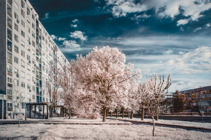

sanykorn
Infravörös (Debrecen)
Nikon D7100
converted 720nm
Nikkor 16-85mm
sanykorn
Nikon D7100
converted 720nm
Nikkor 16-85 (28mm)
f/8
1/80
ISO200
