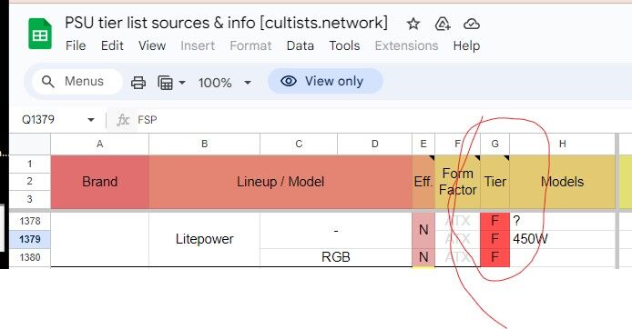

nem vennék rá mérget hogy amit leírnak az igaz. Vegyük alapul a BQ System Power 10-t, ennek a sorjában ez van írva: Borzalmas hullámosság-szűrés, különösen a 12V-os ágon (jóval 100mV felett teljes terhelés alatt), az OCP nincs megfelelően beállítva, alacsony hatásfok, gyenge minőségű ventilátor.
Ehhez mérten, egy korábbi, már nem elérhető tesztben, ezek a dolgok nem voltak említve.
Ahogy ebben a jelenlegi reviewban is abszólut más eredmény van: [link] vagy ezen [link]
RIPPLE 12V 550W 33 mV, 5V 10mV 3.3V 6mV
Efficiency 89%
Transient delta 100mVÍrtam is a fejlesztőnek, amire ezt a választ kaptam:
We are in the process of developing a sources list. It's almost done and will be publicized once it's completed. The reason our list has different information than theirs is because their list hasn't been updated in over two years, and our methodology is stricter in some ways. Tier E doesn't necessarily mean dangerous, it just basically means that it is problematic and we don't recommend buying it. In the case of the System Power 10, it's built by HEC using a platform that is significantly out of date. The OCP triggering points aren't necessarily problematic on the whole, but they need to be set relative to the capability of the platform. Because the platform is so weak, the ripple is allowed to get to nearly 200mV before the OCP kicks in on 12V, which is well beyond the ATX specifications. Ripple is barely within spec on 12V even without an overload. The low efficiency is relative to other units in its class. Although it bears a Bronze badge, it barely qualifies for 80 Plus Bronze and really performs with an efficiency curve similar to 80 Plus White. The low quality fan doesn't refer to the noise, it refers to the fact that it's a sleeve bearing fan made by a budget manufacturer, which, again, isn't competitive with other units in its class. This data comes from Aris Mpitziopoulous from HWBusters.com. He's also the lab director for Cybenetics.
Lastly, we definitely can do exactly that. It's our tier list. Just because you don't agree with the rankings doesn't mean it's wrong. The methodology is clearly posted. You can always do as we did and take hundreds of hours out of your time and make your own tier list. Nobody seems to want to do that. I'm not sure which units you're objecting to being tier E, but we don't give out E or F ratings unless there's a good reason to do so. Hope that helps.Éppen egy forráslistát fejlesztünk. Szinte kész van, és a befejezése után közzé is tesszük. Azért tartalmaz a mi listánk eltérő információkat, mint az övék, mert az ő listájuk több mint két éve nem lett frissítve, és a mi módszertanunk bizonyos szempontból szigorúbb. Az E kategória nem feltétlenül jelent veszélyeset, egyszerűen azt jelenti, hogy problémás, és nem javasoljuk a megvásárlását. A System Power 10 esetében a HEC gyártja egy jelentősen elavult platform felhasználásával. Az OCP (túláramvédelem) kioldási pontjai összességében nem feltétlenül problémásak, de a platform képességeihez kell igazítani őket. Mivel a platform nagyon gyenge, a hullámosság a 12V-os ágon csaknem a 200mV-ot éri el, mielőtt az OCP bekapcsol, ami messze meghaladja az ATX specifikációkat. A hullámosság a 12V-os ágon terhelés nélkül is alig felel meg a specifikációknak. Az alacsony hatékonyság a kategóriájában lévő többi egységhez viszonyítva alacsony. Bár Bronz minősítéssel rendelkezik, alig éri el a 80 Plus Bronz szintet, és valójában egy 80 Plus White-hoz hasonló hatékonysági görbével rendelkezik. Az alacsony minőségű ventilátor nem a zajra vonatkozik, hanem arra a tényre, hogy egy költségvetés-orientált gyártó által készített siklócsapágyas ventilátor, ami ismételten nem versenyképes a kategóriájában lévő többi egységgel. Ezek az adatok Aris Mpitziopoulostól származnak a HWBusters.com-ról. Ő a Cybenetics laboratóriumi igazgatója is.
Végül pedig, határozottan meg tudjuk csinálni pontosan azt. Ez a mi kategória listánk. Csak azért, mert nem értesz egyet a rangsorolással, az nem jelenti azt, hogy téves. A módszertan egyértelműen közzé van téve. Bármikor megteheted, amit mi tettünk, és több száz órát rászánhatsz az idődből, hogy elkészítsd a saját kategória listádat. Úgy tűnik, senki sem akarja ezt megtenni. Nem vagyok biztos benne, hogy mely egységek E kategóriába sorolása ellen tiltakozol, de nem adunk E vagy F besorolást anélkül, hogy jó okunk lenne rá. Remélem, ez segít. -
