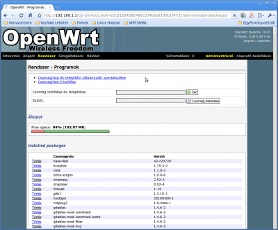

Specification:
- stable version - backfire 10.3
- vlan (eth0.1 - lan, eth0.2 - wan) â� used by swconfig
- failsafe mode is working
- swconfig is added
- block-extroot and block-mount are added to mount the disc as root**
- WLAN's diode is active while using wireless network
- usb's diode is reacting while adding and removing usb devices, eg storage
- lots of packets are compiled. They make using openwrt easier, eg. nano, adduser, deluser, htop, tar, gzip, bash.
- full mc is compiled - FTP Link, Shell Link added as well as unpacking archives (that is tar.gz, tar.bz2 or ipk)
- full wget compiled
- samba3 (my mod) is added
- partition and disc format tools compiled (fdisk, mkfs.ext2/ext3/vfat)
- QSS button turns on and off the QSS diode. There is no function adjusted to it right now.
- openwrt.groov.pl packets' repositories added
- europe/warsaw time set
- shell's history activated
- transmission gui(9091) i port(51515), ftp(21), ssh(22) and www(80) open form WAN side
- modified versions of vsftpd transmission* in a repository
- a patch on busybox to work with plowshare (getopt and coreutils-tr addedLehet benéztem a gui wan port nyitást :-)

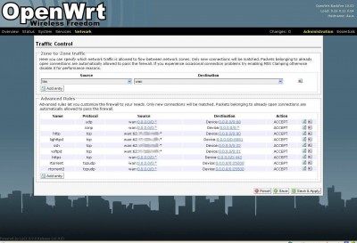

tomi7711 #483 üzenetére
a config fájlban benne van de szerintem te is az alapértelmezett portot használod ami az 51413
ezt kell belemásolni a /etc/config/firewall fájlba:config 'rule'
option 'target' 'ACCEPT'
option 'src' 'wan'
option 'proto' 'tcpudp'
option 'dest_port' '51413'
option '_name' 'torrent-port'vagy a webfelületen írod be, mind1
amúgy a ping.eu oldalon tudod is tesztelni h kívülről nyitva van-e
vagy sok torrent oldal kiírja a peer listában h milyen az állapodot, aktív vagy passzív
aktív a megfelelőa teljes firewall fájl tartalma, hátha kell még valami belőle:

option 'output' 'ACCEPT'
option 'forward' 'ACCEPT'
config 'zone'
option 'name' 'wan'
option 'input' 'REJECT'
option 'masq' '1'
option 'mtu_fix' '1'
option 'forward' 'REJECT'
config 'forwarding'
option 'src' 'lan'
option 'dest' 'wan'
config 'rule'
option 'src' 'wan'
option 'proto' 'udp'
option 'dest_port' '68'
config 'rule'
option 'src' 'wan'
option 'proto' 'icmp'
option 'icmp_type' 'echo-request'
config 'include'
option 'path' '/etc/firewall.user'
config 'rule'
option 'src' 'wan'
option '_name' 'torrent-web'
option 'dest_port' '9091'
config 'rule'
option 'src' 'wan'
config 'rule'
option 'src' 'wan'
option '_name' 'ssh'
option 'dest_port' '21'
config 'rule'
option 'src' 'wan'
option '_name' 'ftp'
option 'dest_port' '22'
config 'rule'
option 'src' 'wan'
option '_name' 'web'
option 'dest_port' '80'
config 'rule'
option '_name' 'mpd'
option 'src' 'wan'
option 'dest_port' '8000'
config 'rule'
option '_name' 'mpd2'
option 'src' 'wan'
option 'dest_port' '6600'
ljungberg: gyári vagy moddolt fw?
