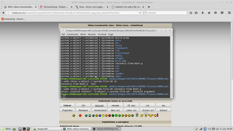

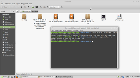

Mr Dini
#24687
Chrootbol probaltam letorolni, majd ujra visszatenni a selinux csomagot, de ezt dobja:
semodule deferred processing now taking place
Error opening /etc/selinux/ubuntu/contexts/files/file_contexts.local: No such file or directory
libsemanage.sefcontext_compile: sefcontext_compile returned error code 255. Compiling /etc/selinux/ubuntu/contexts/files/file_contexts.local
libsemanage.semanage_install_active: Could not copy /etc/selinux/ubuntu/modules/active/file_contexts.homedirs to /etc/selinux/ubuntu/contexts/files/file_contexts.homedirs. (No such file or directory).
/usr/sbin/semodule: Failed!
dpkg: error processing package selinux (--configure):
subprocess installed post-installation script returned error exit status 1
Errors were encountered while processing:
selinux
E: Sub-process /usr/bin/dpkg returned an error code (1)Es rebootnal csak annyit ir, hogy nem tudja elerni a /root/selinux mappat, mert read only a fajlrendszer...
Pedig chrootbol lehet hasznalni...
Szerk.: masodik nekifutasra ezt kapom:
root@ubuntu:/# apt-get install selinux
Reading package lists... Done
Building dependency tree
Reading state information... Done
selinux is already the newest version.
0 upgraded, 0 newly installed, 0 to remove and 50 not upgraded.
1 not fully installed or removed.
After this operation, 0 B of additional disk space will be used.
Do you want to continue? [Y/n] Y
E: Can not write log (Is /dev/pts mounted?) - openpty (2: No such file or directory)
Setting up selinux (1:0.11) ...
Generating grub configuration file ...
Found linux image: /boot/vmlinuz-4.4.0-38-generic
Found initrd image: /boot/initrd.img-4.4.0-38-generic
Found linux image: /boot/vmlinuz-4.4.0-36-generic
Found initrd image: /boot/initrd.img-4.4.0-36-generic
Found linux image: /boot/vmlinuz-4.2.0-42-generic
Found initrd image: /boot/initrd.img-4.2.0-42-generic
Adding boot menu entry for EFI firmware configuration
done
* Starting SELinux autorelabel [ OK ]
Processing triggers for initramfs-tools (0.103ubuntu4.4) ...
update-initramfs: Generating /boot/initrd.img-4.4.0-38-genericDe a hiba ugyanaz...
Lenry
Mr Dini
#24687
miért kellett bármit feltelepítened a gépedre az Androidon való módosításhoz?
pláne partíciómodosításhoz...Gondolom, mert a chrootba nincs felcsatolva a /boot, csak azt nem tudom, h azt hogy kéne kivitelezni....
# mount /dev/sdXy /ahováMountoltadAChrootoltRendszert/boot
egyáltalán külön partíción volt a /boot?
