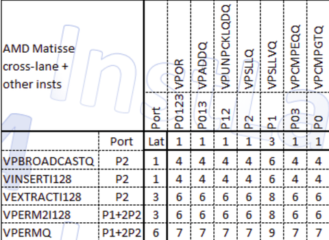

independent virtual machine."Amúgy a szakszerű válasz:
"Although #AMD #Matisse is good at the usual vertical and in-lane horizontal instructions, it struggles with the cross-lane ones. E.g. VPERMQ/VPERMPD still uses 3 uops (it seems they are P1+2P2; 6|1.25 instead of 6|0.6 in the instlat dump) vs 3|1 of Skylake"
https://twitter.com/InstLatX64/status/1152293280102719490.. cross-lane instructions megértéséhez: AVX/AVX2 -es utasításokkal függhet - össze;
S_x96x_S
Latency ...
"on #AMD Matisse not just shifts get penalty after cross-lane instructions"
Q:"The first numeric column (1,1,3,3,6) and the first numeric row (1,1,1,1,3,1,1 ish) - what do they represent?"
A:"The normal instruction latency. The matrix values should be the sum of these values, e.g. VPERM2I128+VPUNPCKLQDQ 3+1 = 4 clks" -

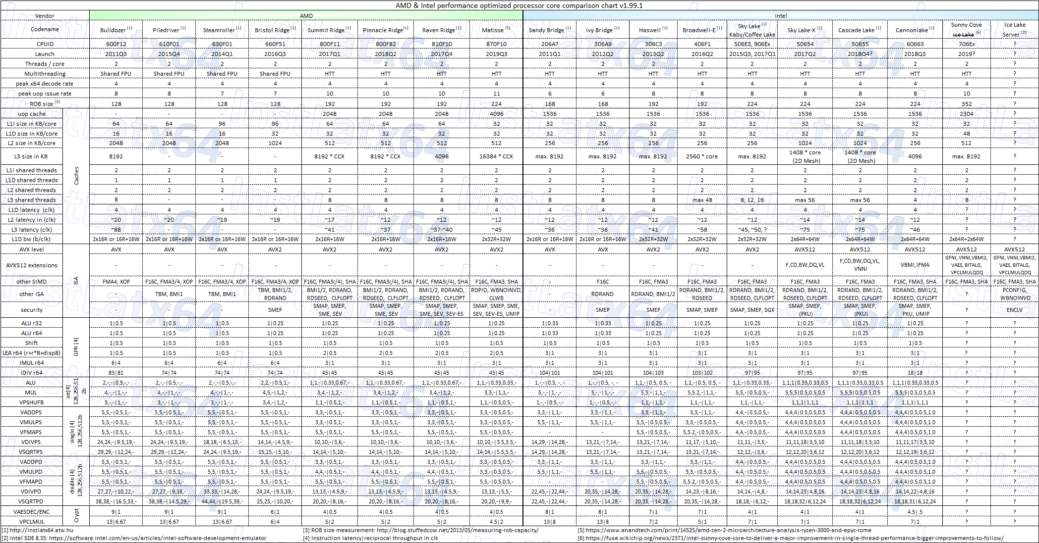

AMD - Intel cpu összehasonlítás - az új Matisse ( ZEN2 ) procikkal bővítve.
"CPU comparison chart refreshed to 1.99.1 No FMA4 on AMD Matisse " ( kép: 4096x4096 - érdemes új ablakban megnyitni a képet )
https://github.com/InstLatx64/InstLatx64/blob/master/CPU_chart_v1991.pngOctaCore AMD Ryzen 7 3700X (Matisse) 870F10 x64 InstLat dump:
https://github.com/InstLatx64/InstLatx64/blob/master/AuthenticAMD0870F10_K17_Matisse_InstLatX64.txt -
