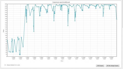

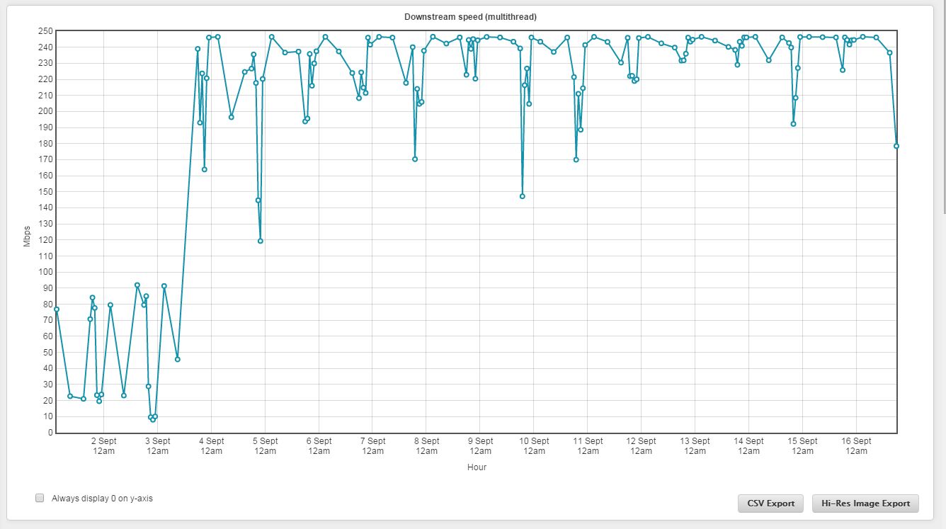

Ha annyira hiányolod az SK-s eredményeket akkor itt vannak azok is:
Letöltési:
Date Downstream speed (multithread) (Mbps) Min Max Samples
1st Sep, 2015 46.66 19.61 84.10 9
2nd Sep, 2015 46.20 8.07 91.92 9
3rd Sep, 2015 177.91 45.60 246.06 8
4th Sep, 2015 203.52 119.35 246.45 9
5th Sep, 2015 225.45 193.77 246.45 9
6th Sep, 2015 228.24 208.28 246.46 9
7th Sep, 2015 220.35 170.30 246.45 9
8th Sep, 2015 239.01 220.37 246.56 9
9th Sep, 2015 224.03 147.16 246.42 9
10th Sep, 2015 219.27 169.96 246.03 9
11th Sep, 2015 232.78 218.95 246.46 9
12th Sep, 2015 240.24 231.65 246.44 9
13th Sep, 2015 241.62 229.01 246.47 9
14th Sep, 2015 231.22 192.23 246.47 9
15th Sep, 2015 242.86 225.81 246.45 9
16th Sep, 2015 221.65 178.43 246.46 9
17th Sep, 2015 236.96 211.12 245.79 9
18th Sep, 2015 240.52 227.77 246.45 9
19th Sep, 2015 227.04 151.10 246.45 9
20th Sep, 2015 230.43 186.39 246.45 8
21st Sep, 2015 212.63 130.71 246.44 9
22nd Sep, 2015 217.61 161.19 246.03 9
23rd Sep, 2015 222.37 191.14 246.47 9
24th Sep, 2015 236.23 215.46 246.10 9
25th Sep, 2015 214.23 130.80 246.48 9
26th Sep, 2015 203.74 93.19 246.46 9
27th Sep, 2015 194.59 100.36 245.79 9
28th Sep, 2015 222.02 161.64 246.44 7
29th Sep, 2015 246.10 245.85 246.34 2Feltöltési:
