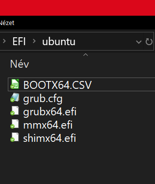

Na, tenyleg megoldotta az Ubuntu live boot a Debian telepito hianyzo mmx64.efi problemajat! !!!!!!
Ezt mar Debian alol irom. Soha viszont nem latasra Win 11...Angol nyelvu magyarazat:
It is related to secure boot. The previously aborted installation was done with secure boot on. Installer create Mok variables in UEFI NVRAM which require MokManager to process on next boot.
Normally, next boot is from installed internal drive which normally have mmx64.efi. But installation is aborted and cannot boot.
Next boot with USB drive, the first program is \EFI\BOOT\bootx64.efi (shim). Shim detects Mok variables which need MokManager to process, it loads \EFI\BOOT\mmx64.efi which does not exist and fails.
If secure boot is disabled later, Mok variables still exist and shim still wants to load MokManager from \EFI\BOOT\mmx64.efi and fails unless \EFI\BOOT\mmx64.efi file exists. -
