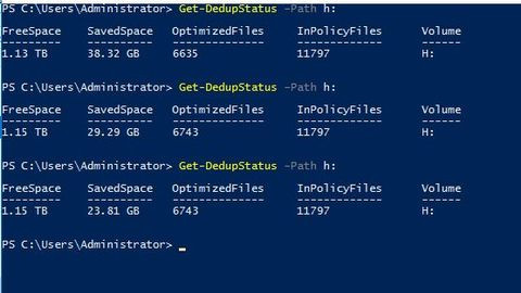

Na eredmény egy veeam backupon:
Evaluated folder size: 21,99 GB
Files in evaluated folder: 1Processed files: 1
Processed files size: 21,99 GB
Optimized files size: 12,90 GB
Space savings: 9,09 GB
Space savings percent: 41Optimized files size (no compression): 13,83 GB
Space savings (no compression): 8,16 GB
Space savings percent (no compression): 37Files excluded by policy: 0
Files excluded by error: 0Ez jól hangzik.

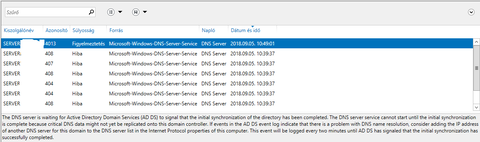

Ezek vannak:
408: The DNS server could not open socket for address 10.xxx.xxx.xxx.
Verify that this is a valid IP address for the server computer. If it is NOT valid use the Interfaces dialog under Server Properties in the DNS Manager to remove it from the list of IP interfaces. Then stop and restart the DNS server. (If this was the only IP interface on this machine and the DNS server may not have started as a result of this error. In that case remove the DNS\Parameters\ ListenAddress value in the services section of the registry and restart.)If this is a valid IP address for this machine, make sure that no other application (e.g. another DNS server) is running that would attempt to use the DNS port.
For more information, see "DNS server log reference" in the online Help.
407:The DNS server could not bind a User Datagram Protocol (UDP) socket to 10.xxx.xxx.xxx. The event data is the error code. Restart the DNS server or reboot your computer.
404:The DNS server could not bind a Transmission Control Protocol (TCP) socket to address 10.xxx.xxx.xxx. The event data is the error code. An IP address of 0.0.0.0 can indicate a valid "any address" configuration in which all configured IP addresses on the computer are available for use.
Restart the DNS server or reboot the computer.Széttúrás alatt azt értem, hogy megváltozott az ip cím tartományunk, C osztályról A osztályra. Másik maszk, átjáró. A kábeles gépeken amíg a tartományba léptettem őket, a DNS-nek a szerver ip-jének kellett lennie, sőt azután is maradt, mert csak így csatolta fel a profilban megadott közös mappát. Azt én b..tam el, hogy ilyen formában adtam meg (gondolom ezért lassú a belépés, mert nem találja):

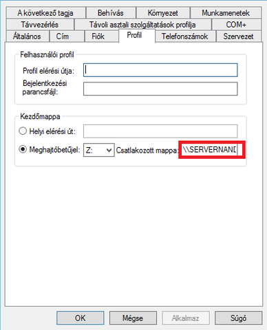

\\192.168.x.x\iroda
Ezt most átírtam erre: \\SZERVERNÉV\iroda így jó, viszont a DNS-el még mindig baja van.
Tehát ha a kliensen a szerver ip a DNS van akkor van közös mappa, de nincs net és fordítva ha a cisco892 által biztosított dns van akkor van net, de nincs mappa.(#19562) Timer
Igen jó, de ekkor nincs a klienseken net, sőt a szervern se, az új fix ip-vel. -

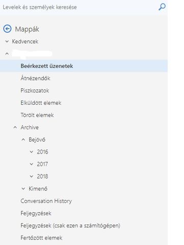

Erre írtam feljebb, hogy mivel kézzel kezdett el mappákat létrehozni Outlook alatt az "Archive" mappában, lehet, hogy ezzel akaratlanul beindította a policy-t? A címke tulajdonságaiban látszik, hogy műveletként archiválás van kiválasztva, nem törlés.
A biztonság kedvéért az alapértelmezett 2 évet átírtam tegnap éjjel 10 évre, de ezzel utólag már nem sokat érek.

Köszi a választ! Outlook 2016. Az archiválás minden fiókban tiltva van (elvileg), de a kolléga a gyári archive mappába kezdett el almappákat létrehozni, és oda behúzogatni a leveleket. Az az alapértelmezett levélmegtartási szabály aktív a teljes tartományon, ami 2 év után áthelyezi az archív mappába a leveleket, ha van archív mappa, de elvileg ez semmit nem csinál, ha nincs indítva archiválás kézzel. Esetleg az pöffenthette be a szabályt, hogy elkezdett mappákat létrehozni az Outlook "Archive" alatt? Ennek ellentmond, hogy egyrészt eltűntek a levelei, nem kerültek be semelyik archív mappába, másrészt hiányoznak két évnél "fiatalabb" hónapok, miközben vannak két évnél idősebb levelek is a megmaradtak között.
OWA-ban belépve a fiókja alá a lomtár törölt elemek visszaállítása a kiszolgálóról (vagy hasonló) menüpontjában megtaláltam szerintem majdnem mindent, de ugyanennek az outlookos megfelelője csak nagyjából 1 hónapnyi levelet mutat visszamenőleg, pedig két nappal ezelőtt kezdett el trükközni vele, tehát ha törlődtek a levelek akár a rendszer, akár a user által, az most törlődött. Sajnos az OWA alól nincs olyan opció, hogy CTRL+A és visszaállítás, ehelyett egyenként kellene bepipálni több ezer levél előtt a checkboxot, majd visszaállítani. Egyébként néhányat kipróbáltam, és a forrásmappákba állítja vissza a tartalmat, tehát nem a user által kreált mappákba.
Valami ötlet az egyszerű visszaállításra, esetleg tipp a helyre, hogy hol kereshetném még a leveleket? A user kezét meg majd letöröm, ha alkalmam nyílik rá, csak ezen legyünk túl...
