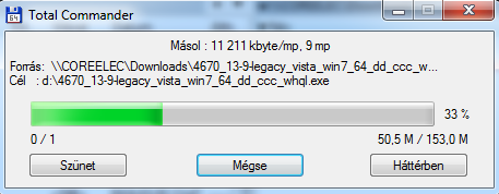

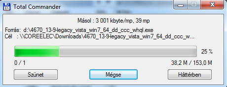

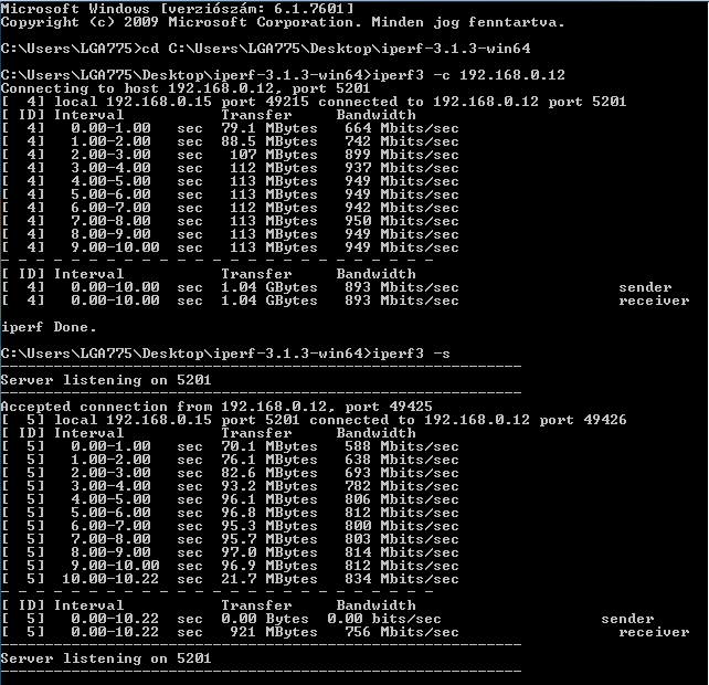

Válasz: (#53490) Csicsóka
Megnéztem LE alatt is, gondoltam hátha a CE a ludas. Sajnos nem:
login as: root
root@192.168.0.20's password:
# LibreELEC #
# https://libreelec.tv #
LibreELEC (community): 8.2.3.1 (S905.arm)
LibreELEC:~ # iperf3 -s
Server listening on 5201
Accepted connection from 192.168.0.15, port 51854
[ 5] local 192.168.0.20 port 5201 connected to 192.168.0.15 port 51855
[ ID] Interval Transfer Bandwidth
[ 5] 0.00-1.00 sec 1.37 MBytes 11.5 Mbits/sec
[ 5] 1.00-2.00 sec 2.94 MBytes 24.7 Mbits/sec
[ 5] 2.00-3.00 sec 3.53 MBytes 29.7 Mbits/sec
[ 5] 3.00-4.00 sec 3.59 MBytes 30.1 Mbits/sec
[ 5] 4.00-5.00 sec 2.77 MBytes 23.3 Mbits/sec
[ 5] 5.00-6.00 sec 3.02 MBytes 25.3 Mbits/sec
[ 5] 6.00-7.00 sec 4.21 MBytes 35.4 Mbits/sec
[ 5] 7.00-8.00 sec 2.78 MBytes 23.3 Mbits/sec
[ 5] 8.00-9.00 sec 2.83 MBytes 23.7 Mbits/sec
[ 5] 9.00-10.00 sec 4.27 MBytes 35.9 Mbits/sec
[ 5] 10.00-10.05 sec 0.00 Bytes 0.00 bits/sec
[ 5] 0.00-10.05 sec 0.00 Bytes 0.00 bits/sec sender
[ 5] 0.00-10.05 sec 31.3 MBytes 26.1 Mbits/sec receiver
iperf3: interrupt - the server has terminated
LibreELEC:~ # iperf3 -c 192.168.0.15 -i 1
Connecting to host 192.168.0.15, port 5201
[ 4] local 192.168.0.20 port 55063 connected to 192.168.0.15 port 5201
[ ID] Interval Transfer Bandwidth Retr Cwnd
[ 4] 0.00-1.00 sec 12.1 MBytes 102 Mbits/sec 0 182 KBytes
[ 4] 1.00-2.00 sec 11.7 MBytes 97.9 Mbits/sec 0 245 KBytes
[ 4] 2.00-3.00 sec 11.4 MBytes 95.6 Mbits/sec 0 272 KBytes
[ 4] 3.00-4.00 sec 10.7 MBytes 89.8 Mbits/sec 0 272 KBytes
[ 4] 4.00-5.00 sec 11.3 MBytes 94.7 Mbits/sec 0 272 KBytes
[ 4] 5.00-6.00 sec 11.2 MBytes 93.8 Mbits/sec 0 272 KBytes
[ 4] 6.00-7.00 sec 11.4 MBytes 95.3 Mbits/sec 0 273 KBytes
[ 4] 7.00-8.00 sec 11.5 MBytes 96.7 Mbits/sec 0 273 KBytes
[ 4] 8.00-9.00 sec 10.8 MBytes 90.6 Mbits/sec 0 273 KBytes
[ 4] 9.00-10.00 sec 11.3 MBytes 94.5 Mbits/sec 0 273 KBytes
[ 4] 0.00-10.00 sec 113 MBytes 95.1 Mbits/sec 0 sender
[ 4] 0.00-10.00 sec 112 MBytes 94.3 Mbits/sec receiver
iperf Done.
LibreELEC:~ # -
cof
Szia.
Most elővettem a tartalék box-ot, Sunvell T95X S905X, tettem az SD-re egy CE 8.0.1-et, és meglepetésemre ugyanazt tapasztalom mint a másik gépen, azt nem hinném, hogy egyszerre 2db Box-al probléma lenne, valami nem stimmelhet a hálózaton, csak nem tudom, hogy mi...
CoreELEC:~ # iperf -c 192.168.0.15
[ 5] local 192.168.0.20 port 49816 connected to 192.168.0.15 port 5201
[ ID] Interval Transfer Bitrate Retr Cwnd
[ 5] 0.00-1.00 sec 12.6 MBytes 105 Mbits/sec 0 255 KBytes
[ 5] 1.00-2.00 sec 11.2 MBytes 93.8 Mbits/sec 0 272 KBytes
[ 5] 2.00-3.00 sec 11.2 MBytes 94.2 Mbits/sec 0 273 KBytes
[ 5] 3.00-4.00 sec 11.2 MBytes 93.8 Mbits/sec 0 273 KBytes
[ 5] 4.00-5.00 sec 11.4 MBytes 95.7 Mbits/sec 0 273 KBytes
[ 5] 5.00-6.00 sec 10.8 MBytes 90.6 Mbits/sec 0 273 KBytes
[ 5] 6.00-7.00 sec 11.7 MBytes 98.0 Mbits/sec 0 273 KBytes
[ 5] 7.00-8.00 sec 11.2 MBytes 94.2 Mbits/sec 0 273 KBytes
[ 5] 8.00-9.00 sec 11.3 MBytes 94.5 Mbits/sec 0 273 KBytes
[ 5] 9.00-10.00 sec 10.8 MBytes 90.2 Mbits/sec 0 273 KBytes
[ 5] 0.00-10.00 sec 113 MBytes 95.0 Mbits/sec 0 sender
[ 5] 0.00-10.00 sec 112 MBytes 94.2 Mbits/sec receiver
iperf Done.CoreELEC:~ # iperf -s
Accepted connection from 192.168.0.15, port 51217
[ 5] local 192.168.0.20 port 5201 connected to 192.168.0.15 port 51218
[ 5] 0.00-1.00 sec 2.64 MBytes 22.1 Mbits/sec
[ 5] 1.00-2.00 sec 2.96 MBytes 24.8 Mbits/sec
[ 5] 2.00-3.00 sec 2.86 MBytes 24.0 Mbits/sec
[ 5] 3.00-4.00 sec 3.78 MBytes 31.7 Mbits/sec
[ 5] 4.00-5.00 sec 3.29 MBytes 27.6 Mbits/sec
[ 5] 5.00-6.00 sec 2.81 MBytes 23.6 Mbits/sec
[ 5] 6.00-7.00 sec 3.27 MBytes 27.5 Mbits/sec
[ 5] 7.00-8.00 sec 3.78 MBytes 31.7 Mbits/sec
[ 5] 8.00-9.00 sec 2.81 MBytes 23.6 Mbits/sec
[ 5] 9.00-10.00 sec 2.88 MBytes 24.1 Mbits/sec
[ 5] 10.00-10.14 sec 1.29 MBytes 77.6 Mbits/sec
[ 5] 0.00-10.14 sec 32.4 MBytes 26.8 Mbits/sec receiver
-----------------------------------------------------------Egy Technicolor TC7200-as modemet használok, ő a router is, 120/10Mbit UPC-m van:
