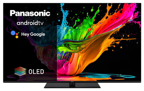

Kérdés mi lesz a különbség az MZ700 és 800 között, mert valaminek kell lennie. MZ700 lehet a full belépő, az MZ800-nak többet kell adnia. Azért fura mert LZ800 most is létezik bizonyos piacokon ami közel azt tudja mint az LZ980, csak gyengébb hangrendszere, meg még egy-két sallangban kevesebbet nyújt.
nagyon érdekesnek tűnik az MZ700 és 800 belépő kategóriás .
60 Hz semmi extra az A3 konkurenciájaként. tehát olcsó lesz elméletileg és fapados, de OLED . -
Panasonic unveils new MZ2000, MZ1500, MZ980, MZ800 & MZ700 OLEDs for 2023, as well as its first Mini LED TV (MX950) at Berlin launch event.
1,
MZ2000: Panasonic’s brightest OLED ever, with MLA OLED panel & multi-layered heatsink to achieve 1500 peak nits at D65 white point. 2 out of 4 HDMI ports support 4K 120Hz HDMI 2.1 FRL bandwidth. 55" & 65" versions get MLA panel, whereas the largest 77" model doesn't.
2,
MZ1500: A swivel OLED with integrated speakers, featuring OLED.EX panel + heatsink that can reach 1000 peak nits (55" & 65" only). Shares many features with MZ2000, such as HCX Pro AI processor & 2x HDMI 2.1 ports with 4K 120Hz. Available in 42", 48", 55" & 65".
3,
MZ980: A compact OLED with 2x HDMI 2.1 FRL ports, available in 42", 48", 55" & 65" sizes (UK don't get 65" model). Uses an OLED.EX panel without heatsink or MLA technology.
4,
MZ800 and MZ700: Entry-level OLEDs with Google TV, available in 42-inch, 48-inch, 55-inch, and 65-inch sizes. These use 4K 60Hz HDMI ports with a step-down 4K Colour Engine Pro video processor, positioned as direct rivals to LG's A3 60Hz OLED.
MX950: Panasonic’s first Mini LED TV, available in 55", 65" & 75" sizes (UK don't get 75" model). Uses a VA-type LCD panel with quantum dot colours. 2x HDMI 2.1 ports with FRL signalling for 4K 120Hz gameplay. Peak brightness & local dimming zone count unknown.
All Panasonic OLEDs for 2023 feature My Home Screen 8.0 Smart TV OS (except MZ800 & MZ700 which use Google TV), with support for all key video streaming services, improved accessibility options, built-in Alexa voice control or with Google Assistant-enabled devices. -
