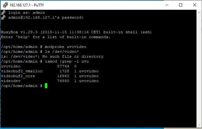

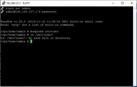

rostiron
Segítséget szeretnék kérni.
Megpróbáltam egy másik kamera beüzemelését, de nem akar összejönni. Most az [itt] irtak szerint a "# ls /dev/video*" parancsra nem a "No such file or directory" kaptam , hanem "dev/video0" ezért folytattam a leírás szerint. Elvileg megcsináltam mindent mégse jó.
A router logba azóta a következő ismétlődik folyamatosan :Jan 3 19:41:10 motion: [1:ml1] [WRN] [ALL] mlp_retry: Retrying until successful connection with camera
Jan 3 19:41:10 motion: [1:ml1] [NTC] [VID] vid_start: Opening V4L2 device
Jan 3 19:41:10 motion: [1:ml1] [NTC] [VID] v4l2_device_open: Using videodevice /dev/video0 and input -1
Jan 3 19:41:10 motion: [1:ml1] [ALR] [VID] v4l2_device_open: Failed to open video device /dev/video0: No such file or directory
Jan 3 19:41:10 motion: [1:ml1] [ERR] [VID] vid_start: V4L2 device failed to open
Jan 3 19:41:10 motion: [1:ml1] [NTC] [ALL] motion_loop: Thread exiting
Jan 3 19:41:11 motion: [0:motion] [NTC] [ALL] main: Motion thread 1 restart
Jan 3 19:41:11 motion: [0:motion] [NTC] [ALL] motion_start_thread: Camera ID: 0 is from /opt/etc/motion/motion.conf
Jan 3 19:41:11 motion: [0:motion] [NTC] [ALL] motion_start_thread: Camera ID: 0 Camera Name: (null) Device: /dev/video0
Jan 3 19:41:11 motion: [1:ml1] [NTC] [ALL] motion_init: Camera 0 started: motion detection Enabled
Jan 3 19:41:11 motion: [1:ml1] [NTC] [VID] vid_start: Opening V4L2 device
Jan 3 19:41:11 motion: [1:ml1] [NTC] [VID] v4l2_device_open: Using videodevice /dev/video0 and input -1
Jan 3 19:41:11 motion: [1:ml1] [ALR] [VID] v4l2_device_open: Failed to open video device /dev/video0: No such file or directory
Jan 3 19:41:11 motion: [1:ml1] [ERR] [VID] vid_start: V4L2 device failed to open
Jan 3 19:41:11 motion: [1:ml1] [WRN] [ALL] motion_init: Could not fetch initial image from camera
Jan 3 19:41:11 motion: [1:ml1] [WRN] [ALL] motion_init: Motion continues using width and height from config file(s)
Jan 3 19:41:11 motion: [1:ml1] [NTC] [ALL] image_ring_resize: Resizing pre_capture buffer to 1 items
Jan 3 19:41:11 motion: [1:ml1] [NTC] [ALL] image_ring_resize: Resizing pre_capture buffer to 4 itemsMár visszacsinálni sem sikerül. Pedig egyszer a kamera led-je világított. Mi tévő legyek ? Segitsen valaki . Akár teamviewer keresztül. Le kéne állítani, hogy a log-ba folyamatosan irja a baját.

Ez az usb-re dugott kamera hogy múködik ? Van egy régi olcsó web kamerám, megoldható hogy a routerba dugva mondjuk telefonon lássam a képet ??
Ezt irta amikor rádugtam.
Dec 24 17:33:16 kernel: usb 1-1: new full-speed USB device number 2 using xhci-hcd
Dec 24 17:33:16 kernel: usb 1-1: New USB device found, idVendor=0c45, idProduct=612a
Dec 24 17:33:16 kernel: usb 1-1: Product: USB camera -

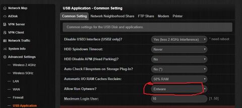

Sracok... vettem egy kulso axagon usb3-as kulso hazat, benne p200-as ssd-vel....
Log-ba ezt irja ki...
Dec 21 21:56:06 kernel: scsi 0:0:0:0: Direct-Access Patriot P200 512GB 0 PQ: 0 ANSI: 6
Dec 21 21:56:06 kernel: sd 0:0:0:0: [sda] 1000215216 512-byte logical blocks: (512 GB/476 GiB)
Dec 21 21:56:06 kernel: sd 0:0:0:0: [sda] Write Protect is off
Dec 21 21:56:06 kernel: sd 0:0:0:0: Attached scsi generic sg0 type 0
Dec 21 21:56:06 kernel: sd 0:0:0:0: [sda] Mode Sense: 43 00 00 00
Dec 21 21:56:06 kernel: sd 0:0:0:0: [sda] Write cache: enabled, read cache: enabled, doesn't support DPO or FUA
Dec 21 21:56:06 kernel: sda: sda1
Dec 21 21:56:06 kernel: sd 0:0:0:0: [sda] Attached SCSI disk
Dec 21 21:56:06 usb_modeswitch: no rule for device 174c:1153
Dec 21 21:56:06 kernel: br0: port 1(eth2) entered forwarding state
Dec 21 21:56:06 kernel: EXT4-fs (sda1): couldn't mount RDWR because of unsupported optional features (400)
Dec 21 21:56:07 automount: Unable to mount device /dev/sda1 (ext4) to /media/AiDisk_a1!
Aidisk wizardnal ezt:You have not plugged any USB Disk or have removed it. Please plug it and use the wizard again.
Mit tudok ezzel kezdeni? -
