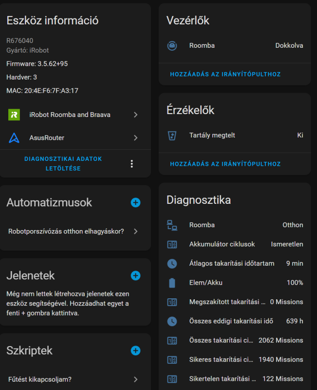

Robotporszívó ajánlást tudnátok esetleg adni (max. 160K).
Ami jó és még a HA is szereti ? -

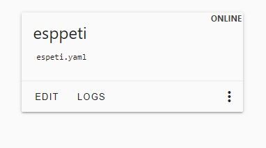

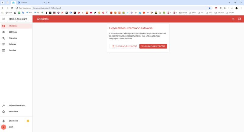

INFO ESPHome 2024.10.2
INFO Reading configuration /config/esphome/espeti.yaml...
INFO Starting log output from 192.168.0.9 using esphome API
INFO Successfully connected to espboard @ 192.168.0.9 in 0.049s
INFO Successful handshake with espboard @ 192.168.0.9 in 0.084s
[17:15:48][I][app:100]: ESPHome version 2024.10.2 compiled on Nov 2 2024, 15:05:00
[17:15:48][C][wifi:600]: WiFi:
[17:15:48][C][wifi:428]: Local MAC: 3C:61:05:14:F9:08
[17:15:48][C][wifi:433]: SSID: 'AX5'[redacted]
[17:15:48][C][wifi:436]: IP Address: 192.168.0.9
[17:15:48][C][wifi:440]: BSSID: 28:D1:27:82:76:3E[redacted]
[17:15:48][C][wifi:441]: Hostname: 'espboard'
[17:15:48][C][wifi:443]: Signal strength: -30 dB ▂▄▆█
[17:15:48][C][wifi:447]: Channel: 1
[17:15:48][C][wifi:448]: Subnet: 255.255.255.0
[17:15:48][C][wifi:449]: Gateway: 192.168.0.148
[17:15:48][C][wifi:450]: DNS1: 192.168.0.1
[17:15:48][C][wifi:451]: DNS2: 8.8.8.8
[17:15:48][C][logger:185]: Logger:
[17:15:48][C][logger:186]: Level: DEBUG
[17:15:48][C][logger:188]: Log Baud Rate: 115200
[17:15:48][C][logger:189]: Hardware UART: UART0
[17:15:48][C][mdns:116]: mDNS:
[17:15:48][C][mdns:117]: Hostname: espboard
[17:15:48][C][esphome.ota:073]: Over-The-Air updates:
[17:15:48][C][esphome.ota:074]: Address: 192.168.0.9:3232
[17:15:48][C][esphome.ota:075]: Version: 2
[17:15:48][C][esphome.ota:078]: Password configured
[17:15:48][C][safe_mode:018]: Safe Mode:
[17:15:48][C][safe_mode:020]: Boot considered successful after 60 seconds
[17:15:48][C][safe_mode:021]: Invoke after 10 boot attempts
[17:15:48][C][safe_mode:023]: Remain in safe mode for 300 seconds
[17:15:48][C][api:140]: API Server:
[17:15:48][C][api:141]: Address: 192.168.0.9:6053
[17:15:48][C][api:143]: Using noise encryption: YES -

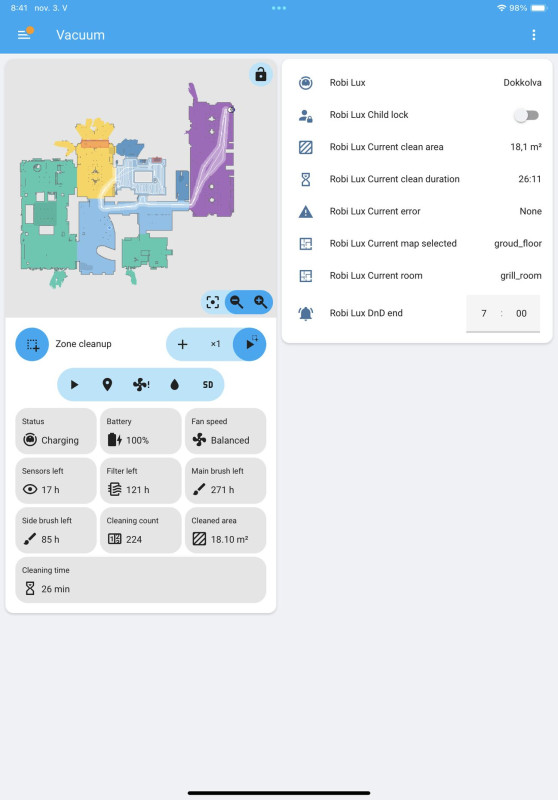

Xiaomi Miio integrációban a Roborock S5 porszívóm elérhetetlenné vált. A XiaomiHome app látja, onnan minden funkció működik. Minden más eszköz Xiaomi eszközzel az integráció hibátlanul működik. Az ismert hibák oldalon is láttam hasonló bejelentést, az magától megjavult.
Felhős eléréssel sem látja az integráció...
Más nem tapasztalt hasonlót?

Egy ideje a xiaomi Bt hőmérőim leszakadtak a HA-ról. A BT átjáró egy ESP board. Ez az ESP nem tudom jól működik-e, onlinet Ír de régen volt ott egy zöld pötty is úgy emlékszem, most csak szürkén Írja, hogy online, a cuccon a led is csak pirosan világÍt, nem tudom az jó-e. Viszont nyomtam egy installt az is lefutott wireless.Hol kezdjem a hibakeresést?

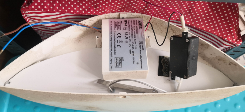

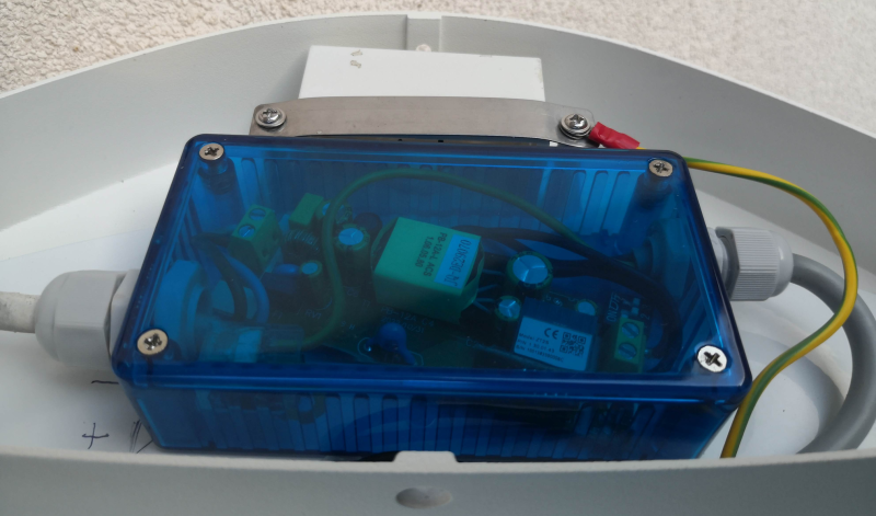

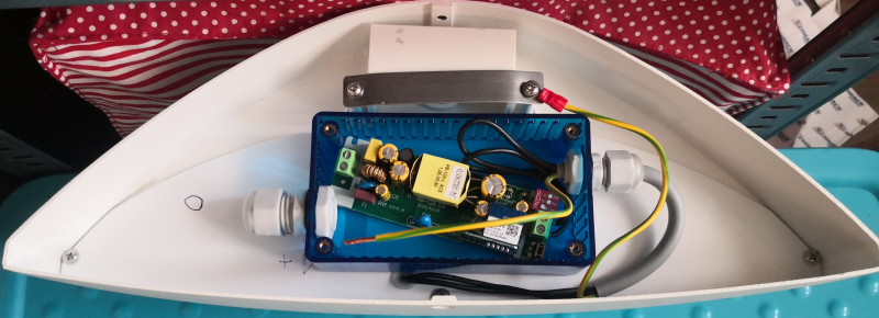

Újabb CE jel áldozás. Az alany: 2 db kültéri EGLO mozgásérzékelős lámpa
Meguntam a béna aszinkron kapcsolgatást (:
Túrtam hozzá egy ZigBee CC drivert és mostmár frigate kapcsolja őket igényesen dimmelve (: -

Valamit elnyomkodtam a file editorba és ez jött be:
Ezzel mit tudok kezdeni? -
