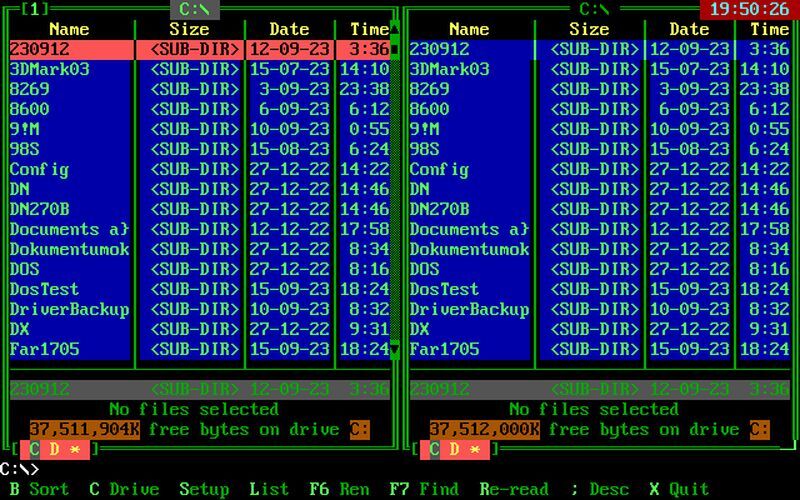

DarthSun
#96391
Config,sys
device=c:\config\limitmem.sys 32
rem new version EMS
DEVICEHIGH=C:\config\HIMEMX.EXE /MAX=32768
rem DEVICE=C:\DOS\HIRAM.EXE
DEVICE=C:\DOS\UMBPCI.SYS
DEVICE=C:\dos\EMM386.EXE RAM
rem DEVICE=C:\dos\HIMEM.SYS
DOS=HIGH,UMB,AUTO
rem end new version EMSrem DEVICEHIGH=C:\dos\SETVER.EXE
rem DEVICEHIGH=C:\dos\IFSHLP.SYS
SHELL=C:\COMMAND.COM C:\ /E:1024 /P
LASTDRIVE=Z
rem DEVICEhigh=C:\HXCD-ROM\LTNIDE.SYS /D:MSCD000
STACKS=9,256
SWITCHES=/F
FILES=20
BUFFERS=20A kimeneti DOS RAMtérkép, ékezet nincs, mert feleslegesen foglalná a helyet nyelvi driver
Az 1 MB alatti mem˘ri t haszn l˘ modulok:
N‚v ™sszesen Hagyom nyos Fels‹ mem˘ria
rendszer 16,880 (16K) 9,648 (9K) 7,232 (7K)
HIMEMX 2,128 (2K) 2,128 (2K) 0 (0K)
UMBPCI 176 (0K) 176 (0K) 0 (0K)
EMM386 4,128 (4K) 4,128 (4K) 0 (0K)
DBLBUFF 2,976 (3K) 2,976 (3K) 0 (0K)
DN 1,072 (1K) 1,072 (1K) 0 (0K)
SMARTDRV 29,120 (28K) 29,120 (28K) 0 (0K)
IFSHLP 2,864 (3K) 0 (0K) 2,864 (3K)
TP7P5FIX 400 (0K) 0 (0K) 400 (0K)
DOSLFN 11,744 (11K) 0 (0K) 11,744 (11K)
CTMOUSE 3,328 (3K) 0 (0K) 3,328 (3K)
COMMAND 7,616 (7K) 0 (0K) 7,616 (7K)
COMMAND 10,704 (10K) 0 (0K) 10,704 (10K)
Szabad 655,552 (640K) 594,608 (581K) 60,944 (60K)Mem˘ria ”sszefoglal sa:
Mem˘riatˇpus ™sszesen Haszn lt Szabad
Hagyom nyos 644,096 49,488 594,608
Fels‹ 104,832 43,888 60,944
Fenntartott 0 0 0
Kiterjesztett 67,003,008 35,986,048 31,016,960
Teljes mem˘ria 67,751,936 36,079,424 31,672,5121 MB alatt: 748,928 93,376 655,552
Legnagyobb v‚grehajthat˘ program m‚rete 594,496 (581K)
Legnagyobb szabad fels‹ mem˘riablokk 58,464 (57K)
Az MS-DOS rezidens a fels‹ mem˘riaterleten.Speedsys txt report eleje :
컴컴컴컴컴컴컴컴컴컴컴컴컴컴컴컴컴컴컴컴컴컴컴컴컴컴컴컴컴컴컴컴컴컴컴컴컴?
System Speed Test Ver 4.70 Report file - created on 15-09-2023 18:48:53
컴컴컴컴컴컴컴컴컴컴컴컴컴컴컴컴컴컴컴컴컴컴컴컴컴컴컴컴컴컴컴컴컴컴컴컴컴?CPU is in V86 mode: No
Processor : AMD K7 4000 MHz
CPUID (TFMS) : 0F10 Codename: Unknown
Feature : 178BFBFFh MMX(tm): Yes, IA SSE: Yes, IA SSE2: Yes
Extended CPUID : 0F10
CPU Name String : AMD Ryzen 7 3800X 8-Core Processor
Extended Feature : 2FD3FBFFh 3DNow!(tm): No, 3DNow! Extensions: No
L1 Cache size : 64 KB
L2 Cache size : 512 KB
Frequency via TSC : 4000.02 MHz
CPU speed index : 6293.40Total memory size : 176 MB
Memory speed index: 2999.60VESA OEM String : NVIDIA
VESA video memory : Unknown (23187 KB/s)Hard drive 0 : 15566C 255H 63S 119.24 GB
Tested in FAST mode
Random access time : .40 ms
Linear verify speed : 18526 KB/s
Linear read speed : 47236 KB/s
Buffered read speed : 12214 KB/s
Hard Drive speed index : 9745.13
Hard drive 1 : 31130C 255H 63S 238.47 GB
Hard drive 2 : 29185C 255H 63S 223.57 GB
Hard drive 3 : 487C 255H 63S 3.73 GBMainboard model : ASUS TUF B450-PRO GAMING
BIOS vendor : American Megatrends, Inc. (09/10/15)
OS version : MS-DOS 7.10
컴컴컴컴컴컴컴컴컴컴컴컴컴컴컴컴컴컴컴컴컴컴컴컴컴컴컴컴컴컴컴컴컴컴컴컴컴? -

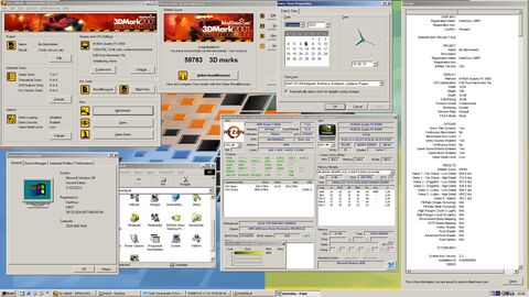

Az első képen az i5-7600K HD630-as Intel IGP-je dolgozott.
