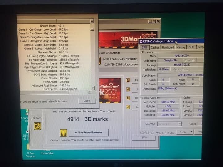

K6 architecture works best with 5.5 multiplier. Do not worry to stress the CPU.
I have some CPUs that will do 112x6 672MHz with only 2.1V
Some CPUs I push as high as 2.5V. I have never killed an AMD K6 2/3/+ CPU.
You will need to update the bios on that motherboard. If you have 1024kb BIOS chip it wont work, you need 2048kb bios chip to take BIOS update to run K6+ CPU. -

Egy újabb technikai segítségkéréssel fordulok hozzátok. Adott egy K6-2+ 533-as porci. Ennek elég fura FSB-t írnak elő: 97 MHz 5.5x
Na most, nekem egy EPoX/ProNiX EP-58MVP3C-M áll a rendelkezésemre, ami csak az alábbi FSB-ket (60MHz, 66MHz, 75MHz, 83MHz, 100MHz) és szorzókat (2 X, 2.5 X, 3 X, 3.5 X, 4 X, 4.5 X, 5 X) tudja. Működésre lehet bírni ezt a procit ebben a lapban szerintetek? Egyelőre nem mertem beletenni, mert nem világos, hogy kéne jumperelni, ha egyáltalán működne. További problémaforrás, hogy a kérdéses procinak 2,0 volt kellene, a legalacsonyabb fesz amit ez a lap viszont 2,1. Köszi előre is a válaszokat! -

That will be awesome to see your results! I have done a few tests but I am so focused on 3DMARK2000/1 world record that I never get to game testing. But I can say my Quake 2 1024x768 Demo 1 gets 160FPs. In game up to 340FPS. Serious sam gets 20-200+fps. I max out a single Voodoo 2 surpassing P3 1400MHz in some tests haha. Modern games likes driver 30.82. Need for speed Porsche you must use the DirectX that shipped with Need for speed hot pursuit 2!! And then the operating system. Win 98/2000/XP? I want to try XP lite and Win98lite. It should help. Then there is one secret left. ATI Radeon cards can run fast. I was able to do it once and never again. I can not remember how I did it
But I know it was Win2000 or XP because there was no registry edit for the ALi AGP. -

Yes, I found the same, Geforce 3 is the best way to get the most out of K6-3, not counting synthetic tests, as it was still being used in the relatively old 8. 05 detonator, which seems to be the sweet spot in terms of performance and compatibility for these cpus, the newer drivers are very cpu overhead, even though the newer and on paper faster vga, the platform will still be slower with the newer drivers. To prove this, I started a test with a lot of game tests from Riva TNT1 to Geforce FX and from 2.09 to 56.64 drivers. Very time consuming but will be instructive once done.
And for that 660 Mhz cpu clock speed, you would need a very lucky cpu and very good cooling (how much voltage is needed?), I don't think we can come close.
Skalabala
Hello, I have been lurking here now and then for many years :p
But I think it is time I do a contribution
P5A, K6-3+, 128MB Ram, Win98, 5950 Ultra
I have not tried to tweak it much so with some luck I could break into 5000
